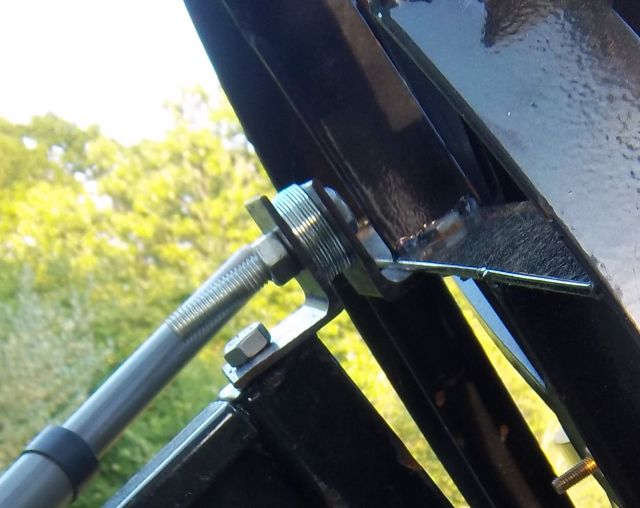

Hi All,
I've been a long time reader of these forums and for years I've always wanted to get a C-band dish (took a while to convince my wife. she says the black-mesh actually looks nicer than my 1.2m KU one!).
I'm at 45.5 latitude so if I calculated right, I need the following:
Latitude 45.5'
Modified Lat. 46.16'
Declination 6.23'
Total 52.39'
I got a Tek2000 8-footer mesh dish and, unless I built it wrong, my declination screw isn't long enough for a 6.23' declination. I bought a long 1/2" SS thread rod which i cut a 7" section that I'll use.
While I wait for a sunny day to switch the screw... I'd like to find which true-south satellite/transponder to use at the top of my arc for tuning/tweaking.
My long. is ~74W so I was wondering if there's any transponders on 72W AMC 3 that I could use for tweaking? If not, what would be the next best sat/tp?
Thanks,
Steph
Edit: I forgot to mention that i do know that lyngsat lists nothing off AMC 3, just want to be sure there's really nothing coming out of that bird... thanks.

Welcome to Satellite Guys Stef! :welcome2 Glad to hear you were able to convince your other half on a c band dish. She should be pleased with the selection of channels available. I had one of their first 8' mesh dishes when they came out. Can't remember if I used the original declination bolt or added one but here is a picture of it.
I'm just shy of 77W here and remember using 72W when I setup my first c band dish a few years back. Sadly, I don't believe there are any channels there now. There are active channels on 78W @ 3885 V 23000. The signal is not real strong but I was able to lock them with a TEK2000 8' mesh though. From the look of the footprint at Satbeams.com they are even weaker at your location. Best bet is probably 87W 4140 V 29125. Luken mux is a good strong signal and should be fairly easy to find. :)

Yes, I remember having to disassemble the declination adjustment a few times until I got the best signal. I was going to use two thin nuts between with no washers because two full size ones were too thick but in the end I choose the large washers because they seemed to make things more 'solid'. I kept my lower pivot bracket straight and have had no issues in three years but don't see any real problem with putting a little bend in it. Be sure to grease everything really well with something that can take the cold weather. The C1-PLL is a solid performer. I use them myself and am very pleased with them. :)
Ok, so using washers, the closest I could get to my declination angle was less than .5 of a degree. Is that ok or do I need to be dead on?
