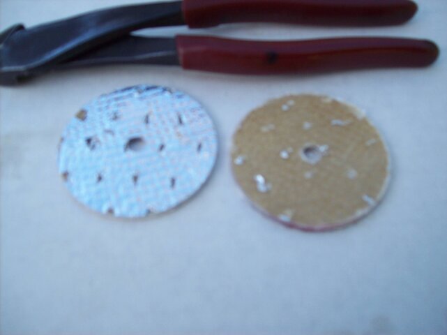

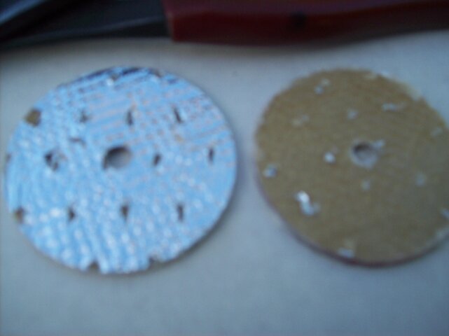

here are some picture of a plug that had to cut in a Mirco-Dine, that we needed to run some 7/8 andrews hard line to the lna's, now the foils was intact it just rip when I tried to pull it apart, but this is what is inside a Mirco-Dine dish.
