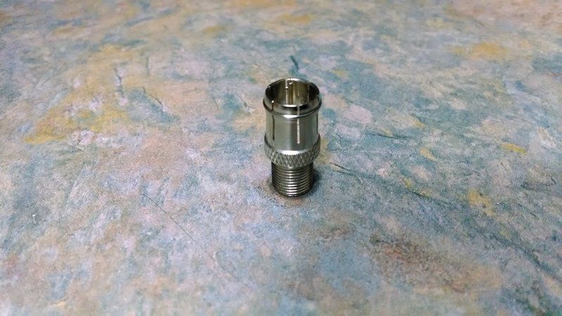

One time when I was experimenting with a powered UHF antenna to extend the Hopper signal, I used a coax F push-on adapter on the Hopper UHF extend cable funny threaded connector. If what ever the project you are working on performs ok, then cut off the one end and affix a standard F connector for a good permanent connection.
