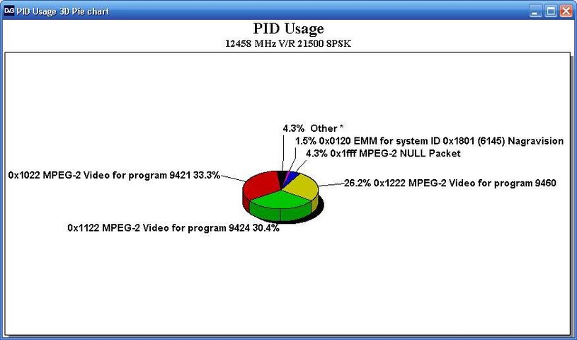

You just can't crank up the bitrate without taking the bits you want from something else. Take this TP for example DiscoveryHD, ESPNHD, SHOHD mux. Notice there aren't any 0x1FFF room left on the bars? 0x1FFF are null packets, as in idle bandwidth. Where are you going to get this extra bandwidth you are asking for?
Like I said... it's not as simple as you think.

Their bitrates aren't up. D*'s current modulation scheme on their 101/110/119 birds only give them about 30mbps a TP. At least E* can crank out 40mbps a TP on their 8PSK muxes.
