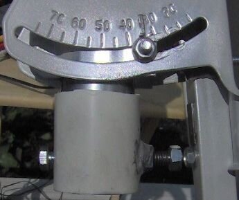

Often wondered how manufacturers arrive at stamping accurate elevation angle gradations on a dish. Are those markings somewhat consistent from one manufacturer to another?
How could one check if the angle stamping is accurate? Set the dish at 90 degrees (that is, dish perpendicular to the earth) using a plumb bob as a reference?
I know about those magnetic circular angle finders, but never figured where to set them on the dish.
I see from past posts that some use the sun to figure out a specific elevation angles and the dish's accuracy.
Thanks.
It's just a guide to get you in the ballpark. It also takes into the equation, the amount of offset the particular dish has. So the indicated angle looks weird. And you need to know if it's Elevation or Latitude being marked. Some dishes have both, one on each side.

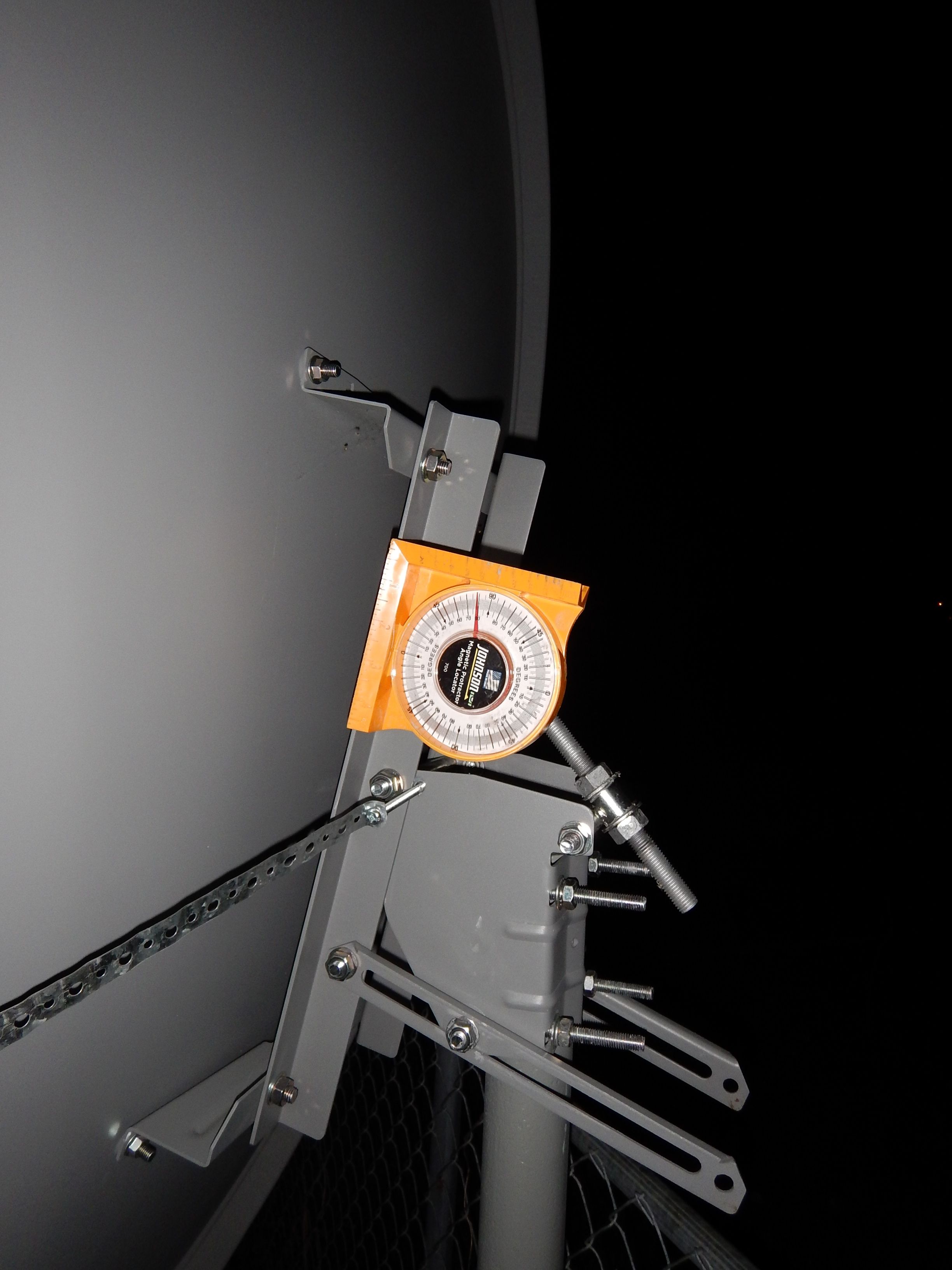

I'll throw this in too. Being a newbie with no dish aiming experience and a dish with no scale, I learned the hard way...

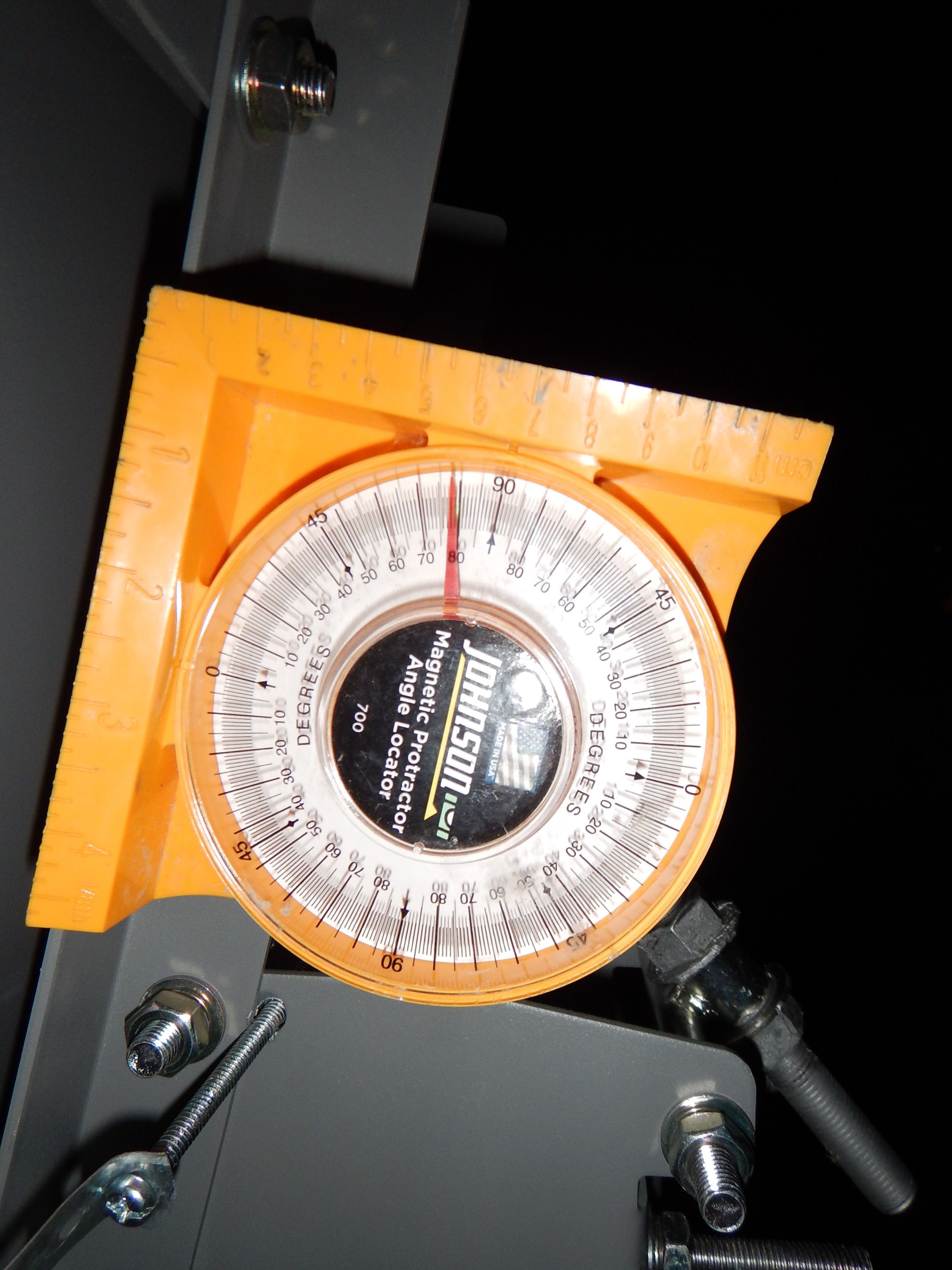

Elevation angle for 125W from dishpointer.com indicated 36.9° elevation. I tried for an extraordinary amount of time around at 36.9° to find a signal. I then found out about offset angles. The Patriot that I have is supposed to have a 27.7° offset angle. I subtracted the 27.7° dish offset from the 36.9° total angle and came up with 9.2° for the dish angle. With that knowledge, it didn't take too long for me to get my first lock... What a surprise and relief.
Anyhow, this is how I used the angle indicator on my particular dish. I believe you have a Channel Master (?), so it will differ.
This is a closeup of the angle indicator with the dish recently peaked (i.e., yesterday) for 125W. In my case, the angle indicator is a few degrees past the 9.2° calculated for my position.
Spongella, maybe this will help you some or at least give others some reference.
EDIT: I used the same angle indicator to ensure the pole was plumb (i.e., 90° N-S and E-W).

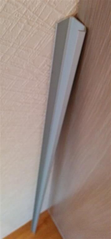

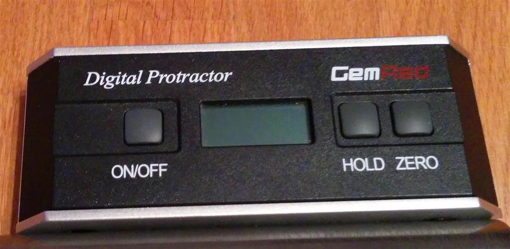

Elevation scale on dish usually useless. The easiest, more proper and precise way how to adjust dish is measure leaning of the "face" of the dish. If we know elevation of the satellite and offset angle of the dish than extract smallest from biggest and final number will be necessary leaning of dish. For example: if satellite has 30* elevation and dish has 22,6* offset angle than the leaning of the dish should be 7,4*. Of course it is better to use digital protractor and metal or wooden plank to do such a measurements.
