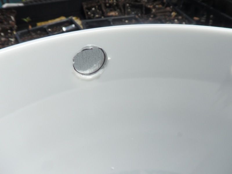

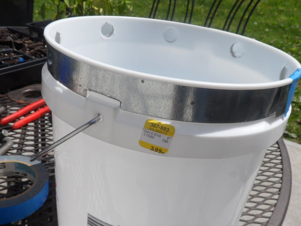

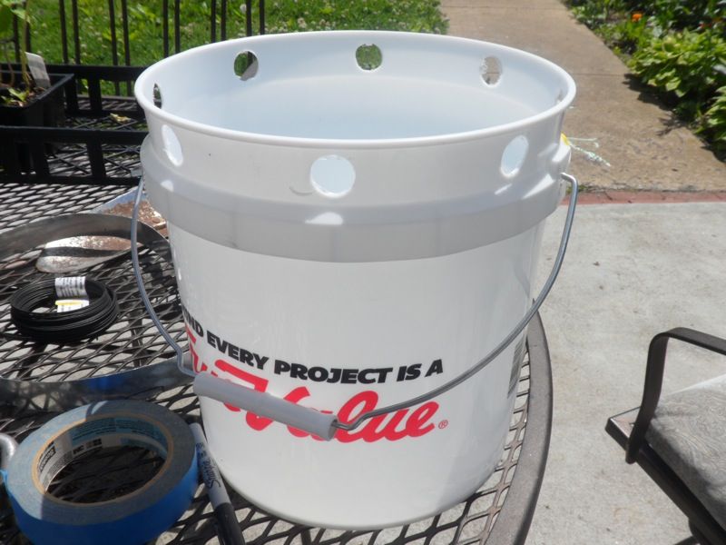

Started off with a 2-gal bucket and marked positions equidistant around the top of the bucket. On this bucket, there were mold reinforcements on the band that the bail attaches that could be referenced. Used a spade bit to cut the holes.

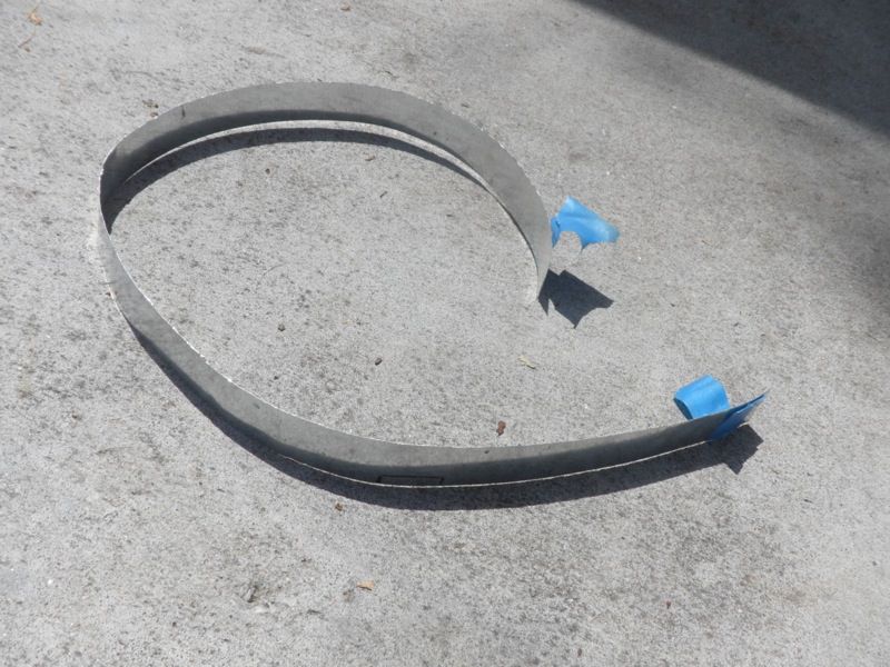

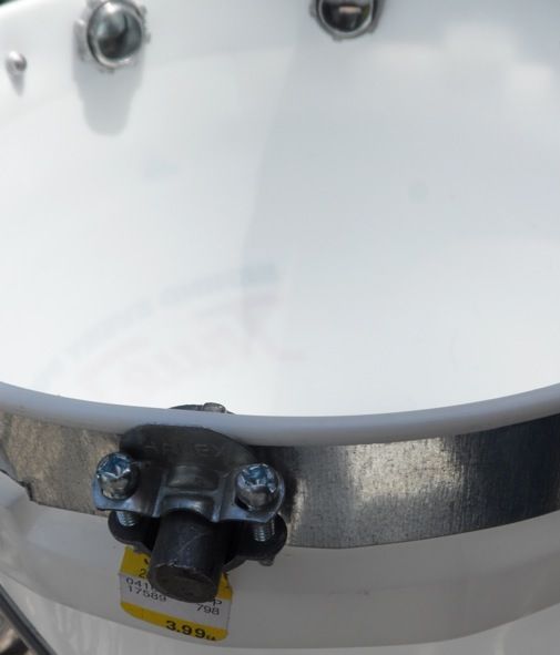

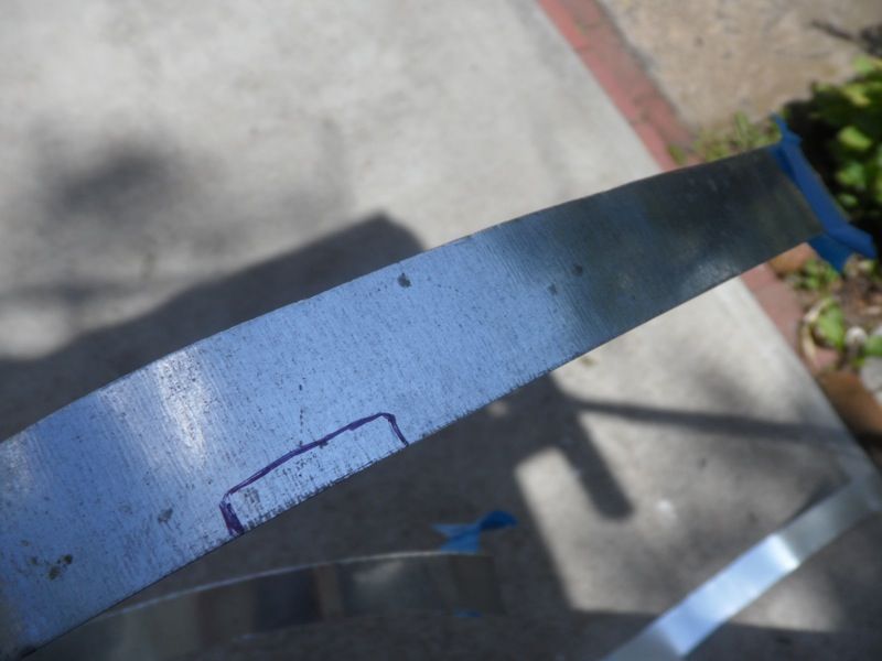

Next, cut a piece of flashing that would fill the space between the bucket reinforcement band and the lip on the top of the bucket. The idea was the band of flashing would fit up into the lip.
Test fit the band to the bucket and decided it needed some trimming to fit around the bail moldings.
After trimming, installed the band onto the bucket for final test fit. I maybe trimmed a bit more than needed.
Marked the band from the inside of the bucket using the holes already drilled.

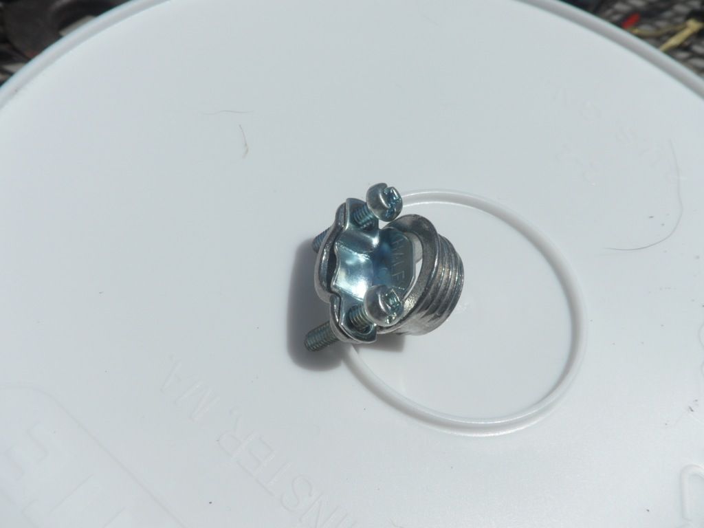

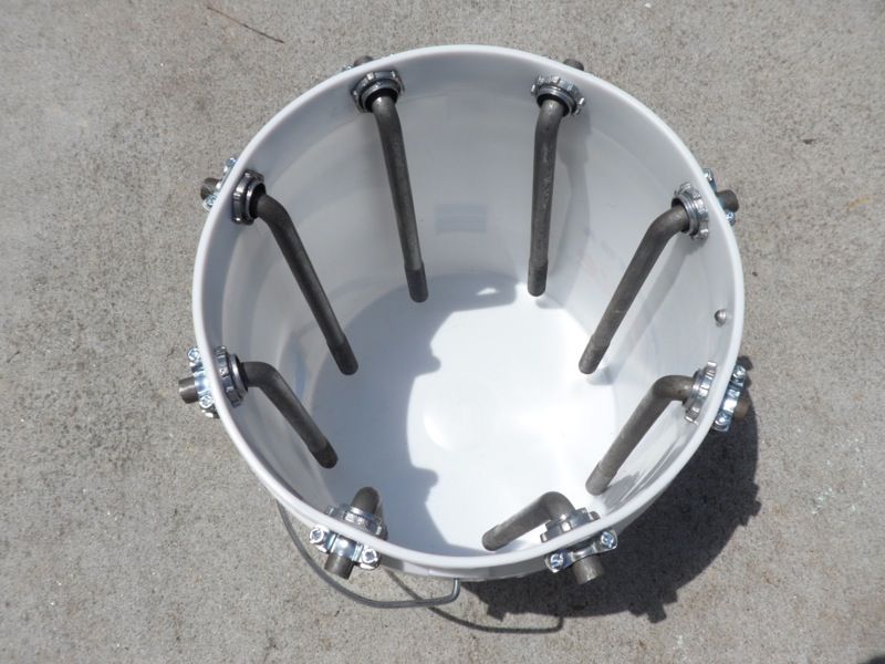

For each hole location, a Romex clamp will be installed.

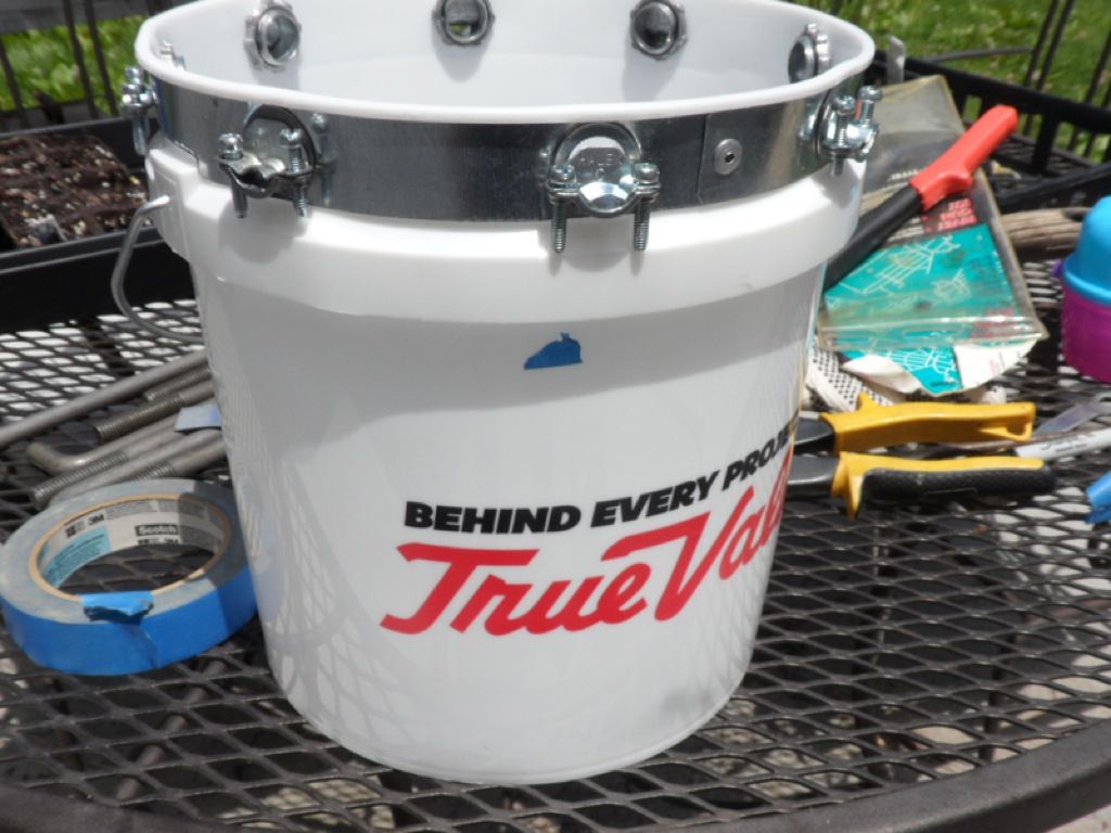

At each hole location, drilled a small hole (3/8") and then used aircraft sheet metal shears to trim out the hole. After creating the hole, inserted the Romex clamp through the band and the bucket hole and threaded the nut onto the clamp. After installation, the band acts as a conductor and reinforcement for the top of the bucket.

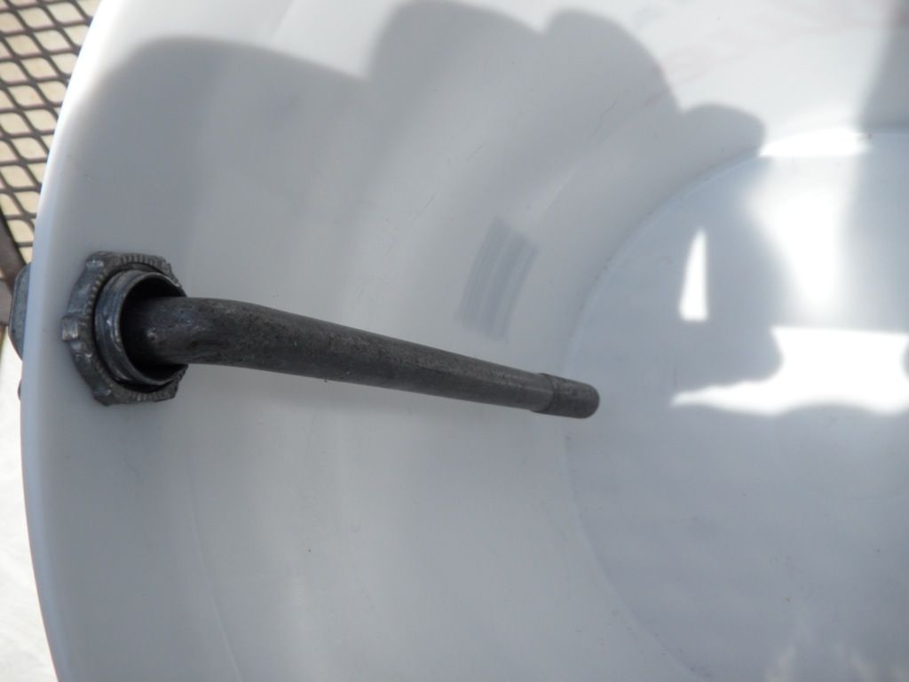

Next installed the sacrificial anode into the bucket. In this case it was 1/2" x 8" mild steel concrete L-bolts clamped into the romex clamps. 3/8" rebar would've been less expensive, but the hardware store was out of stock and didn't want to drive 30-50 miles one way for more. As is, this was around $20 to build.
There is a word of caution with the Stovebolt page instructions about using Stainless Steel, due to the chrome content.
Completed bucket with all anodes installed.

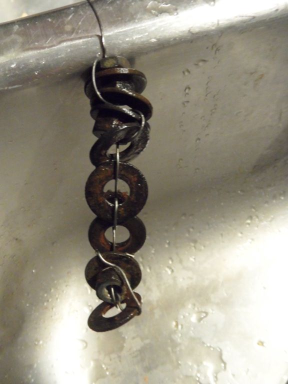

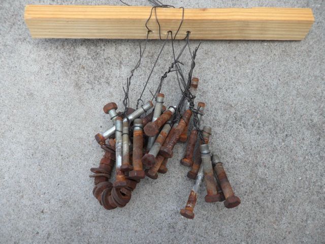

To attach together cathode parts, annealed steel rebar tie-wire was used.
All the parts tied together, going forward will probably result in fewer pieces at one time.

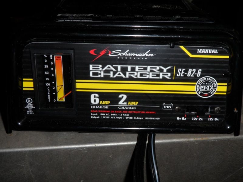

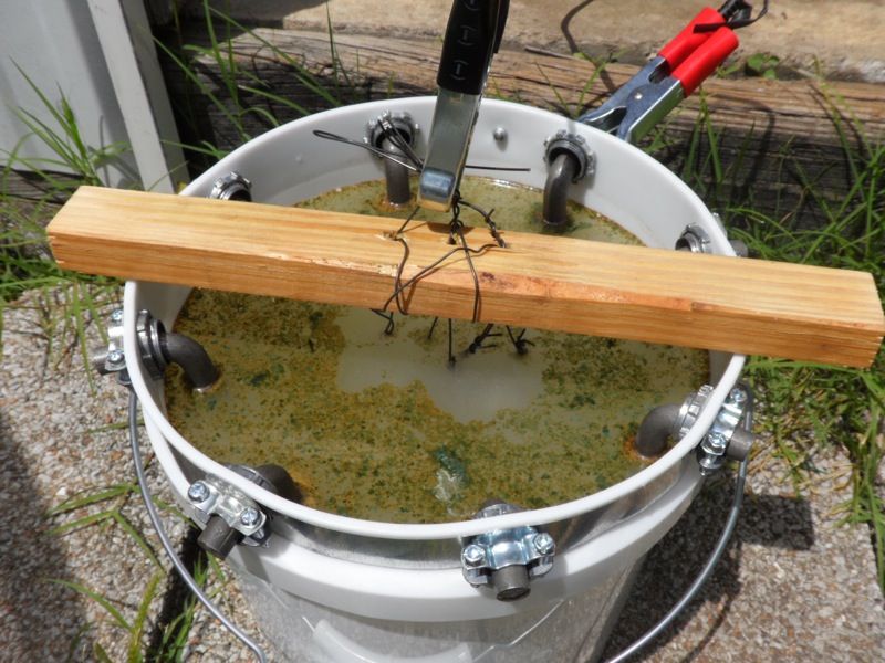

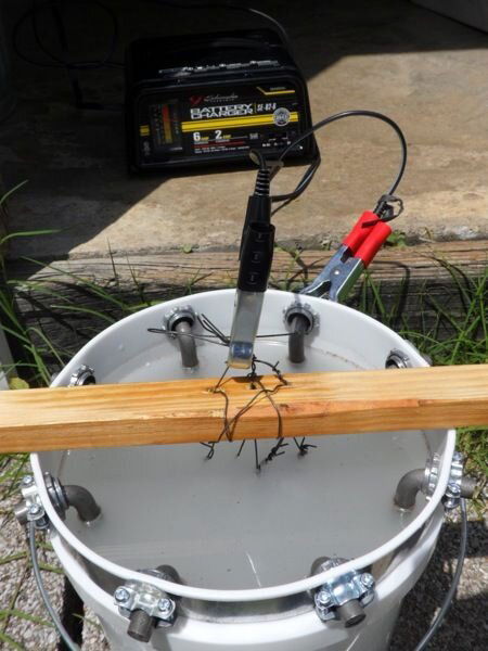

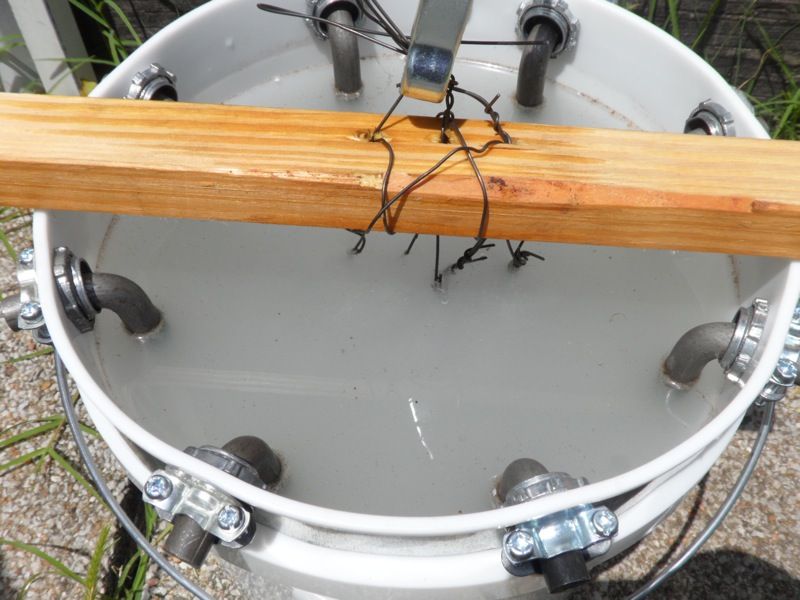

Starting the electrolysis, the negative (-) from a battery charger clipped to the parts (cathode) and the positive (+) is clipped to the bucket sacrificial anode.
Another view at start of process.
Within 30 minutes of process.
After a few hours, a mostly complete rust removal using electrolysis. I wound up cleaning a bit more on these and put them back in until all rusty parts were completely black.
At first, I started with 12v 2A for the process. Wound up with 12v 6A for final cleanup.

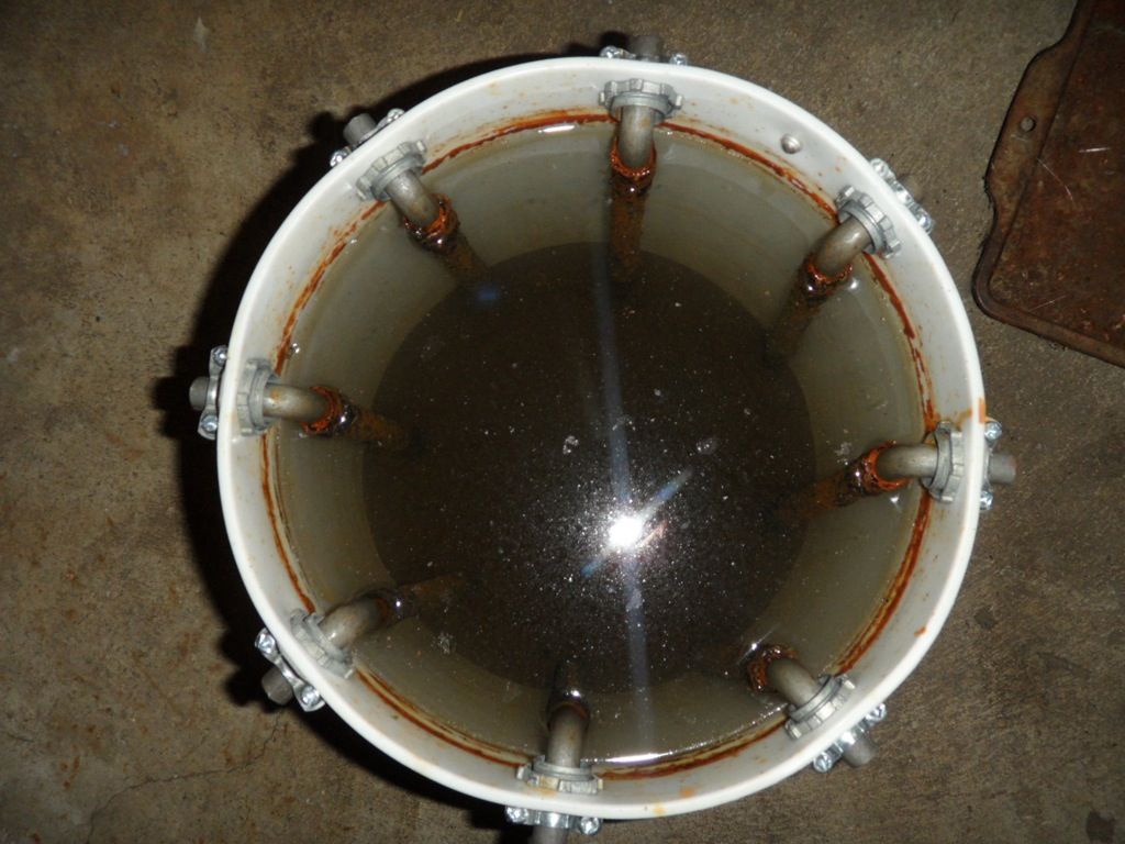

Is the residue from doing this really nasty, or pretty much just rusty water? I might give it a try, if what's left afterward doesn't look too toxic! I like that setup with the bucket and the Romex clamps, that's really a neat setup!
I can't really see the charger you used for this in the picture very well, but if you have one, a better power supply that has a cleaner DC output might work better. That charger looks like it probably would have a bit of AC ripple in the output. With the plating, a power supply with clean output made a huge difference. With just cleaning rust, it might not make quite as much of a difference. Thanks for posting that, cool experiment! Another one to add to my list of things to try! :)

I can't really see the charger you used for this in the picture very well, but if you have one, a better power supply that has a cleaner DC output might work better. That charger looks like it probably would have a bit of AC ripple in the output. Thanks for posting that, cool experiment! Another one to add to my list of things to try! :)

The residue is dirt and rust crud in a washing soda solution. The caveat in the instructions recommended that one does not use stainless steel as the sacrificial anode because of hexavalent chromium release into the solution. Here's a photo after the water has set for a few days and everything has settled out.
The battery charger is a Shumacher from O'Reilly Auto Parts; a middle of the road unit. Probably not a clean DC source, but it worked well enough for rust removal.

Thanks for the PDF, downloaded it to check out later! That water doesn't look bad at all, I'm going to give it a try, thanks!
