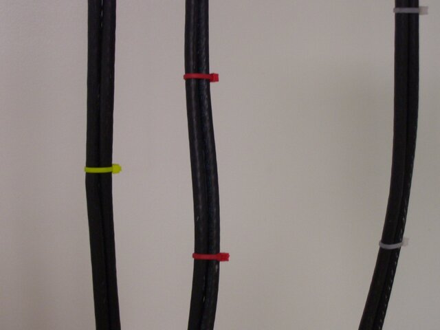

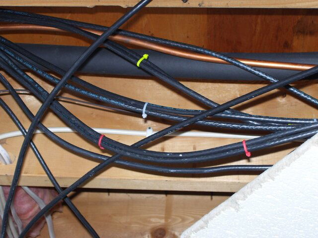

Was reorganizing the cables in the basement (suspended ceiling) and it dawned on me that I had 9 lines coming in there
-antenna
-2 for starchoice
-2 for G16 C-Band
-2 for G18 KU
-2 from the motorized
(also have 4 other cables but those are run somewhere else). So I decided to tie the "pairs" together so when I wire I know which line goes for which dish. Great for troubleshooting. So I use zipties to tie together the G16 lines. As I went to tie the G18 lines together I thought "why use the same color when you have multi-colors"...easier to remember ;)
So I used 3 different colors for each dish and now I know which one goes where
I know it sounds goofy but simplicity is the best way to not be aggravated with our systems :)

Makes sense to me. Been thinking along those lines for all the ones outdoors , lol. If I can come up with a little weatherproof chart I could fix on each dish-pole with the "color code" I'd have it made. When i worked for NPS (the park service not the tv place) I used to make BIG signs like that to go in the parks and at scenic overlooks, etc. But even those never stayed moisture-proof for very long. Maybe its just the humidity down here.
That is how I mark mine. I assign a color for each room. I also assign a color to the "service" (OTA, FTA, DISH, etc).
So a "yellow" "red" might be living room OTA (yellow = living room / red=OTA). I mark them on each end of the cable and I now know what is what :) I keep a list of what is what taped to the lid of my satellite tool box kit. :)

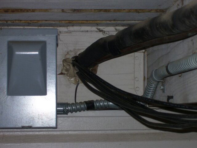

There is a hole that my Central air pipes and wiring run into. I just feed the wires next to it. The hole is big enough for I think 11 wires...or so I've tried ;)
....sometimes its a bugger but it works
There is some stuff that looks like silly putty that plugs the hole. Its a split entry house so the basement is partially above ground. The basement has a suspended ceiling
Here is an older pic
