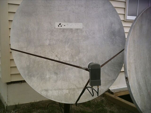

...I have the other type muzak dishes with the 3 arms that come out and a clamp that holds a lnb. I was able to modify it for other types of lnbs.
That looks just like a Prodelin 1.2m I have. I would be most grateful if you would post a closeup pic or two of how you modified the original feed bracket to host the 40mm dia. LNB that was (teasingly) shown!

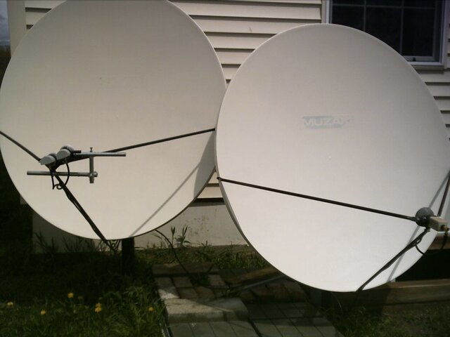

I think at that time I just used some straping with holes in it and put bolts through the holes in the strap and through the holes in the original holders bottom. I do not use that lnb any longer and have since went to this setup with 2 lnbs for 97 and 101.
