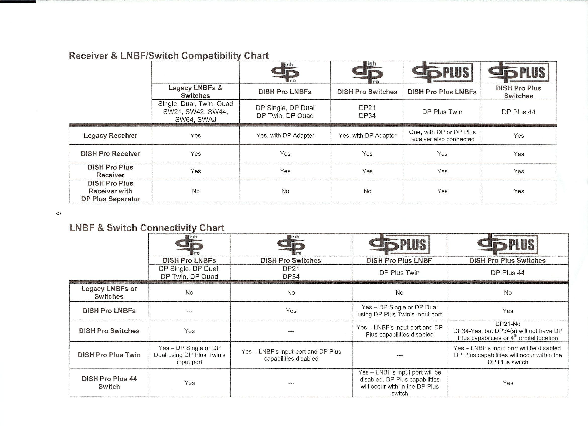

Here is the compatibility chart. Compatibility Chart.JPG:up
