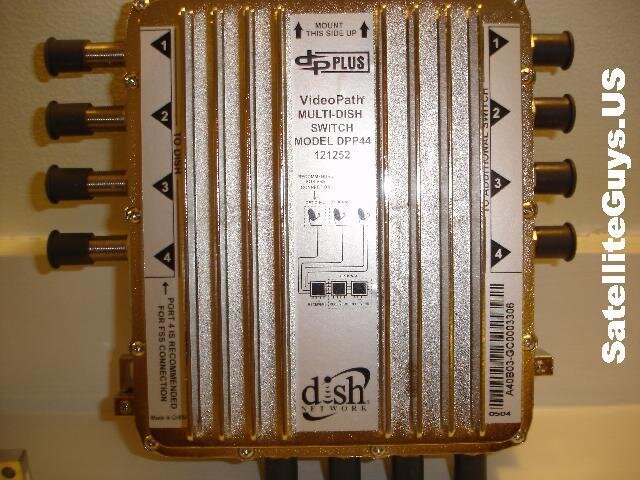

Well after months of delays it is here, the DishPro Plus 44 switch! The multi dish switch billed as the swiss army knife of Dish Network switches. And from the short time I have played with it, it lives up to its billing!

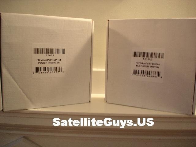

I rushed home from work to find my box from DishStore.NET at my door. I quickly ripped it open to find my long awaited prize jewel inside. (well ok... I opened the box, and in the box there was a box, and inside that box was a box, and inside that box was two more boxes, and one of the boxes even had another box inside!) There was a total of 5 boxes used to ship this monster of a switch!

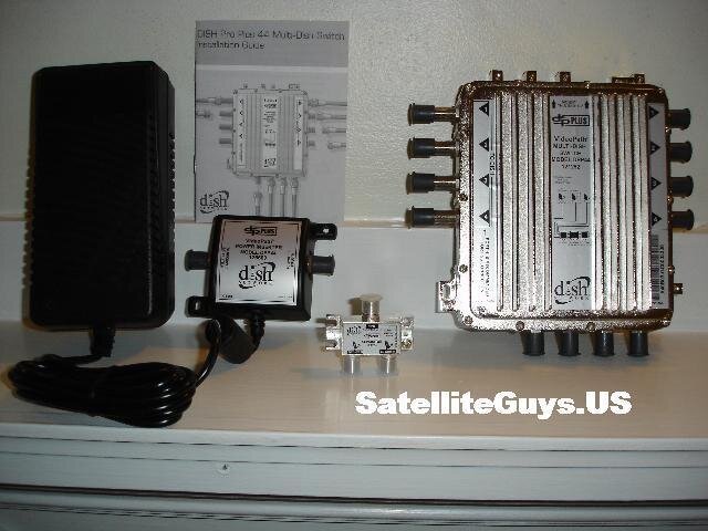

I also found in the box from DishStore.NET 3 Dish Pro Plus separators and a DishPro Dual LNB (I am going to convert my dish at 61.5 from Legacy to DishPro technology)
I quickly went to town getting ready to hook my new switch up.... then I realized something. For each Dish Pro Plus Separator I had I needed two coax jumpers for each one, plus since I was hooking this switch up through my existing DishPro 34 switch I needed jumpers for that as well.
So I hopped into my truck and went to Radio shack, where I purchased all 6 of their 1 Foot RG-6 cables they had in stock. My cost came to $25. I needed to go to Best Buy to get more jumpers. At Best Buy I got three 3 foot jumper cables for $4 each.

Since my DP34 switch is located near one of my 921's I felt that was the best one to setup first. The manual did not really to tell you the order to hook things up, so I opted to get all the cables plugged in then plug in the power for the power inserter.

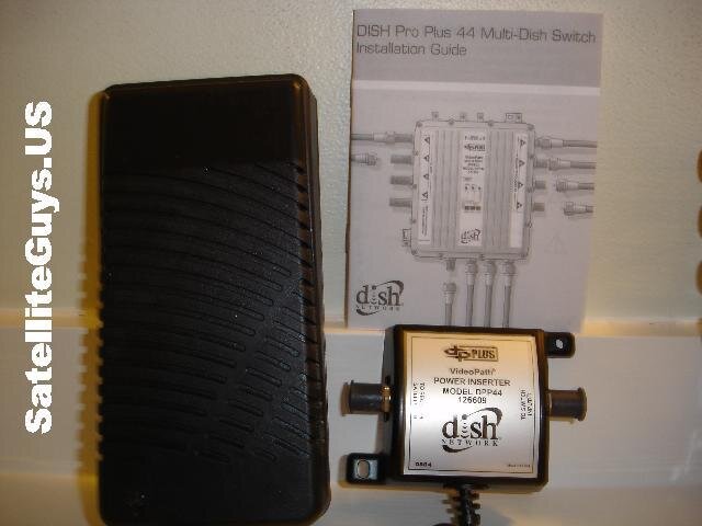

I got everything hooked up, had the satellite feeds going to the switch, and I had the feed from the outside going to the power inserter. Then I realized something, I needed one more RG6 cable to go from the power inserter to the Dish Pro Separator. I did a quick search and found a 3 foot cable (phew!) and hooked it up.

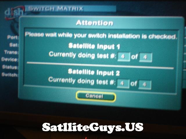

I quickly went to the menus and did a check switch.
A smile came across my face as I saw the screen say it was doing step 1 of 4. (The DP34 does 3 steps) The check switch took around 60 seconds to complete, a little longer then it did with the DP34 switch.

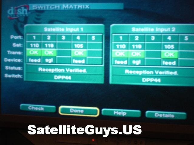

When it was done, I saw what a wanted to see... DPP44 was my switch listed! I was kind of shocked to see that instead of just 4 satellite locations displayed there were actually 5! I guess the DP+44 can be cascaded for a total of 5 satellite locations!

On the sixth photo you included the 921 identifies the Device for the 110/Port 1 as "feed" and 119/Port 2 as "sgl". Any idea what these indicate?
I know that when I do a check switch with the SuperDish using a DP-34 with three satellites at 105, 110, 119 it indicates it as:
Switch Status" Connected to a DP34 with 3 inputs
Port 1 DP Feed 105 Even, Odd
Port 2 DP Feed 110 Even, Odd
Port 3 DP-Dual-2 119 Even, Odd
The Feed indicates one output on the lnbf while the Dual-2 indicates two outputs on the lnbf. The switch only needs one output from each lnbf and I believe some may have two because they just used some that they had from bulk supplies for their Dish500's to use on the SuperDish.
Perhaps the sgl indicates it as being single, the same as feed, that the lnbf would have only one output instead of two.

In the pictures you see the DPP44 switch status, whic is being fed from a SuperDish which is pointed at 105. The SGL is the FSS feed which is fed out by a Dishpro single.
