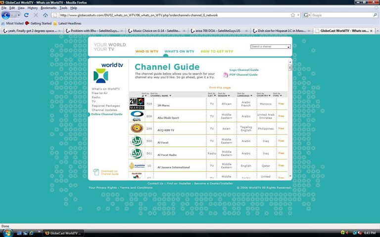

also Globecast's site shows it free on 97W
