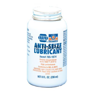

Anti-seize lubricant on the threads of any 'lightly' plated steel hardware (i.e.,non-stainless or non-galvanized steel bolts and nuts).
On my satellite dish hardware, I've used it on: pole to pad nuts/bolts, elevation/declination adjustment nuts, actuator bolts, support arms to dish bolts, Scalar to support arms and so on.
I've learned to really appreciate the stuff over years of rebuilding/restoring antique vehicles... I use it on any nut and bolt that is subject to long term corrosion or exposed to the elements, like exhaust manifold bolts, bumper bolts, spark plugs, shock mount bolts, crossmember bolts, etc. The stuff works well on parts subject to galvanic reactions like steel bolts into aluminum.
