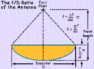

Hi Guys
I am using a Starchoice STAR100 1 M dish and the instructions that were in the box are exacty the same as the Winegard 1M. The Winegard speccs say the focal distance is 59 cm, my question is that 59 cm measured from the center of the dish to face of the lnbf? I ask this because the starchoice dish was supposed to have that stacked lnb and I'm not familiar with it and if it is longer making the face closer to the dish.I measured my lnbf to the dish and it is 64 cm.
Dave

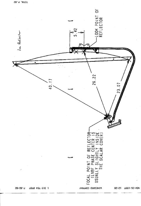

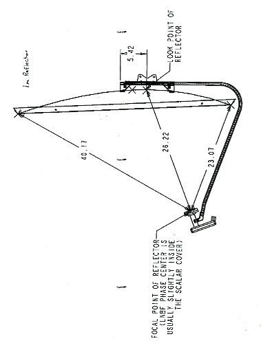

The focal point of the reflector is slightly inside the scalar cover of the LNBF. Measuring from the top of the dish to the focal point 40.17in, from the bottom of the dish to the focal point 23.07in and from the centre of the dish to the focal point 26.22in. The centre of the dish is at the centre of the mounting bracket at the back of the dish. If you make an X out of the four bolts attaching the pan of the dish to the bracket, that is the center of the dish and the point to measure from. I did at one time have a scan of the document from Winegard showing this, but my scanner is no longer connected.

No problem, the drawings speak for themselves, I would use the signal quality as your guide THATS what its all about :)
I did find that I had to bend my LNBF arm some to match the drawing. Also, tighening the bolts holding the arm makes a drastic difference in where the arm is positioned. The trick I used was to use a piece of string with a mark from an ink marker at the focal point, taped to the top and bottom of the dish as a guide when adjusting the arm, then measuring the center measurement as a double check. Once the arm was positioned properly, then use your QUALITY meter on your satellite box to fine tune to. (unless you have a spectrum analizer)
Larry
