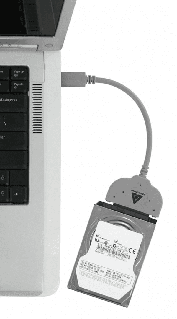

I don't have a 722k receiver. I do have a Wally in my camper that I wanted to enable DVR function on.
I had a connector and a laptop SSD sitting around. I connected them to the Wally and Wallah, he recognized them.
The connector is this: SATA Wire 3.0 - USB 3.0 Interface to any 2.5" SATA Drive
The SSD is a SanDisk 1TB or 2TB SSD, I am not in front of it. There is no enclosure, and I would say, not needed. No external power. Works.
