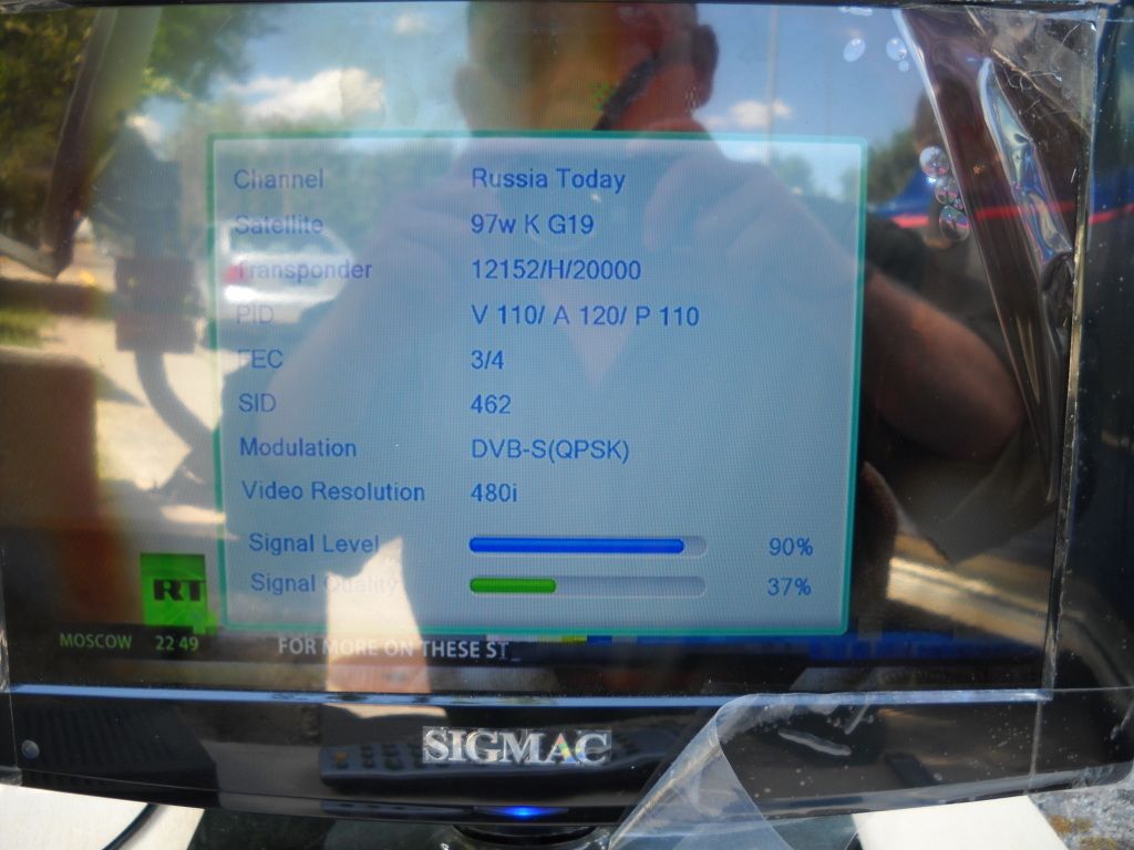

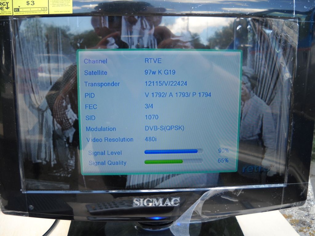

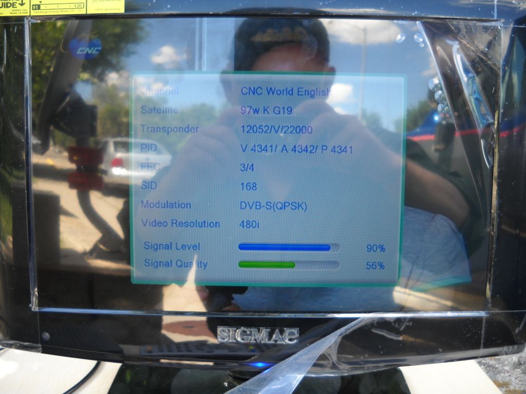

Did some measuring and calculating. Found out I had the LNBF to close to the dish. Did some modification and tried again. Had similar results on 103W, but tried 97W again with some, but minimal, tweaking. Had considerably better luck this time. Ended up with 154 TV channels and 53 Radio stations.
Did get Russia Today, did have some tiling, but was watchable, at least until some cumulus clouds came drifting through. I did not check all the channels, but it appears that everything was DVB-S. Also got a very good signal on Retro TV and REVN, so it will do to show SOME of what is available.
Did snap some photos of the screen, will post a couple later, after I resize them.

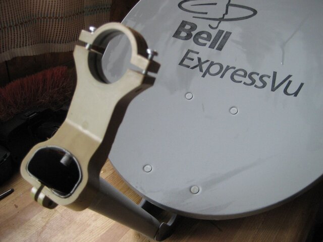

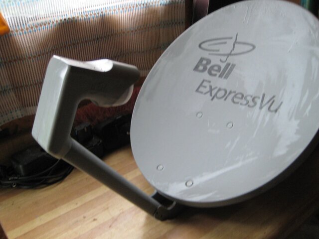

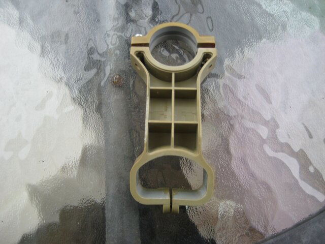

Back in 1998 i had a subscribtion with Bell Expresvue and at the time they were on Anik 107.3 using a linear lnb,
and after a year or so they went circular.
I dont know if Dish Network had linear lnb's but here are photos of what we had.
I have 2 lnb holders like on the pictures and they fit on the dish 500 without remooving the yoke.
I like to play with that 18 inches dish and scan a few sats to see what i can get and dont have to skew the dish just skew the lnb.
