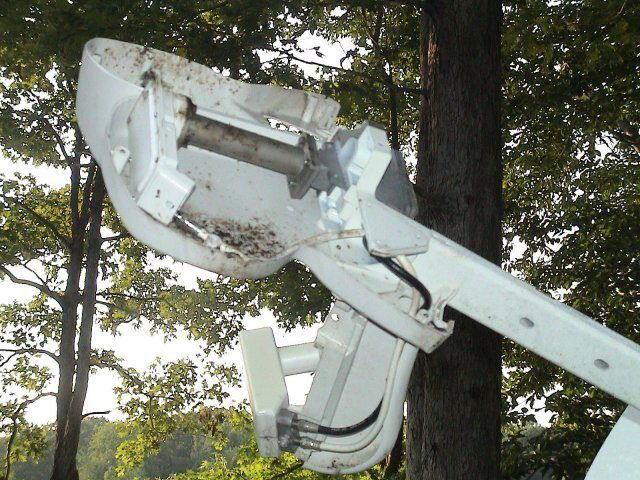

More info
I opened up the LNB cover and you were right - WASPS! As you can see from the attached photo, there is no LNB inside other than the one for Direcway, but I don't see a place for it in there. If the one at the end of the arm is Sat-A (110), and Sat-C (110) goes in the space beside it as you can see in the picture, where do I mount the sat-B LNB?

If you look at the side of the picture facing us there is a white plastic insert, basically the A kit is a specially shaped LNB that fits in that spot, Installing it can be a real pain though depending on if you get an older A kit or the newer one. The newer one will slide down into that slot once you pull off the top gray piece. The older one you have to pull the whole thing apart:(
Anyway, you also need a 4x4 multi-switch to combine the 101 & 119 (and 110 if you keep it).
Good Luck,
WTT
I need to stare at that dish a little harder - I didn't see any place for the LNB. Any idea where I can order a special LNB like that? By the way, I already have another multiswitch 5-in/4-out that should work fine.
David
It won't look like a "normal" LNB. The tip is more like a 1/2" piece of PVC that ends in a point. If I go up to the shop this afternoon I will take a digital picture of one and post it. A quick google images search pulled up nothing.
