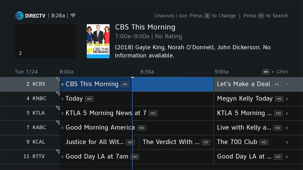

From what I remember it looked a lot like this. It was modern looking, and had channel names in text and not icons. It was in Detroit if that makes any difference.
They probably have either the H44 or H26K receiver, then. No idea why those would be slow, then, since those are both fairly new receivers.
