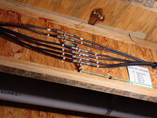

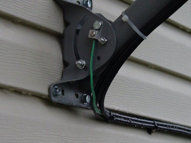

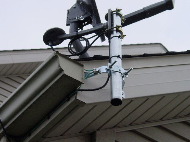

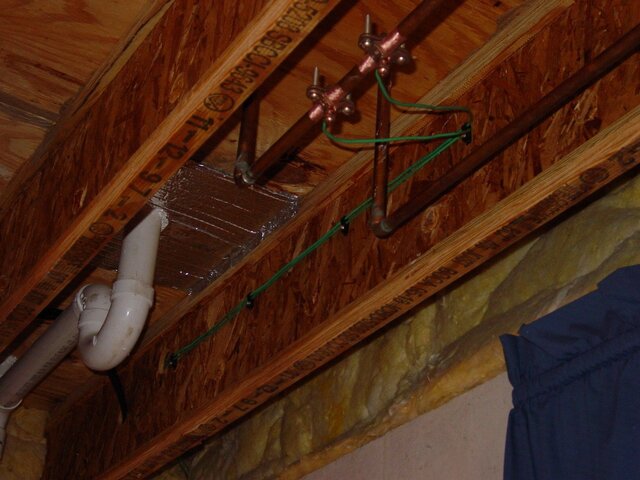

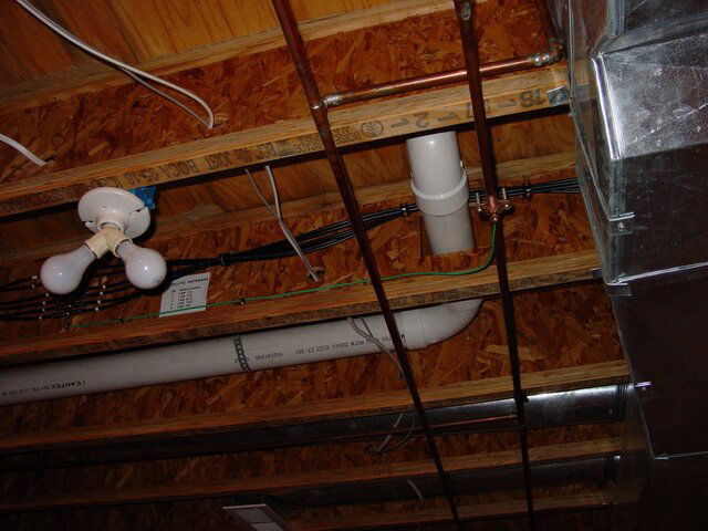

That's pretty much exactly what I did, except I ran to the electrical entrance ground (preferred for a number of reasons, helps avoid "ground loops", etc.) vs. a water pipe that, as others have said, could be a dubious ground. I ran #10 stranded THHN (insulated) wire all the way from the dish itself, alongside the coax cables, through the hole in the wall then located the ground block there, out of the weather. The THHN was stripped at that point but otherwise unbroken. The stripped part is what the ground block contacted, then that wire continued to the panel, about 20' in my case. Avoid any excess wire, "coils", sharp bends (as you are doing), etc. to minimize the inductance. Use some "electrical grease" at the connections to minimize corrosion.
