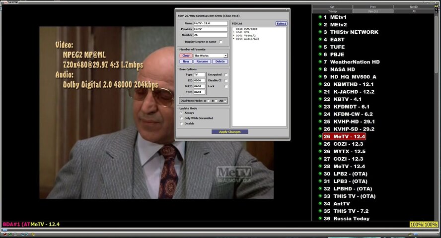

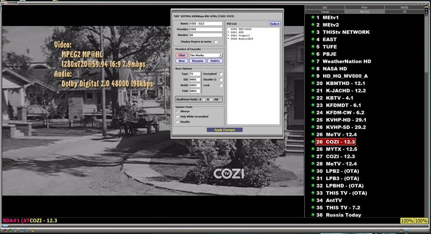

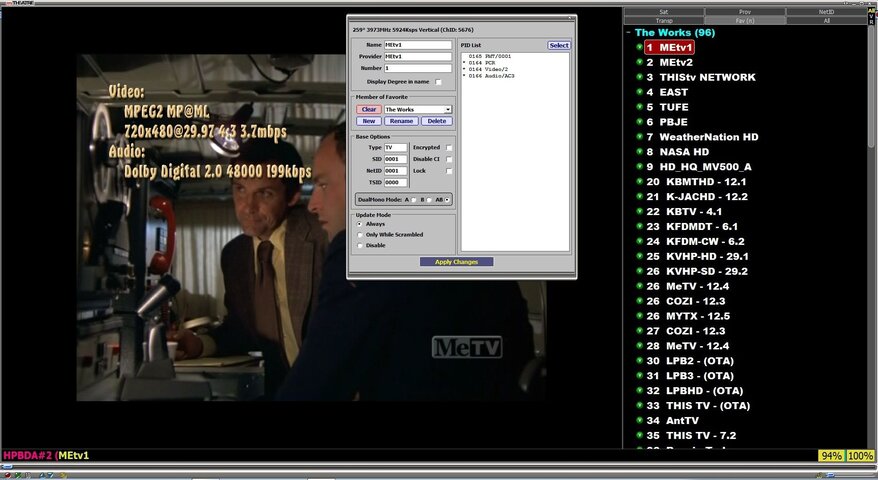

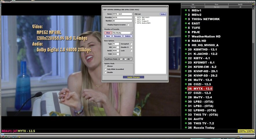

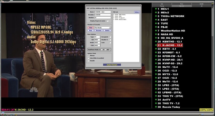

Ok, I think this may help verify what is what here in the area..
I took screen shots of info for each channel then lastly I took a screen shot of info from MeTV coming down from C-band, for the sake of comparison so people can see what they are doing at KBMT with compression and stuff.
(Pay no nevermind to my jumbled channels list on the right side, I need to delete a bunch of old junk from it.. :o )
The screens are self explanatory..
You can see all the SID/PID stuff, the frequencies, resolution, etc...
I have no idea what the Ksps means.. The mbps, I understand to some degree and on each channel it is wild.. 12.1 is lower than 12.3 ! 12.5 is WAAAAAY high! 12.4 is pathetic... Seriously, :wtf: is their methodology/logic here?
Also notice the signal strength and picture quality meters are all at 100%... This is brand new too! Previously I was getting like 96% on 12.1 and 12.2 and average of 68% to 78% on 12.3 and 12.4
the later channels would get very weak after 8pm and start breaking up. By midnight they would be so weak that it was impossible to watch them. Now they are rockin on full tilt after midnight !
I hope this info is helpful..

OThe mbps, I understand to some degree and on each channel it is wild.. 12.1 is lower than 12.3 ! 12.5 is WAAAAAY high! 12.4 is pathetic... Seriously, :wtf: is their methodology/logic here?
OK...I'll try to explain it (well wiki can) ;)
Digital television supports multiple digital subchannels if the approximately 19.4Mbit/s (megabits per second) bitstream is divided
so each station has 19.4 MBits to work with (maximum) to use on their channels. So as example my CBS (WCCO Minneapolis) that has no subchannels (its owned by CBS) uses around 18MBits. The more subchannels you put on the more that bandwidth needs to be split up
The HD channels need more bandwidth so they get priority....but your HD channels bandwidth honestly looks real bad. Typical dual HD stations run between 8-10Mbits and can vary depending on the programming. I mean 4.4Mbits on 12-2? Damn I've seen SD stations use more bandwidth ;)
They may still be moving stuff around bandwidth wise. As for Metv and its low bandwidth, its SD. Thats why. Here in Mpls our MeTV (and ThisTV as they are on same channel) run between 1.6-2.
The MyTX (12-5) looking at the info when it was on 12-3 it was the same bandwidth (11.4 or so) so the channel basically just got renumbered

Anyway.. I've just discovered something interesting about COZI, they are running Bugsy right now and it's in 16:9 format ! And amazingly, it's not stretch/squish-o-vision.
According to the scan info I got yesterday they are broadcasting in 720p. I also just went and looked on my TV info and it too says it's 720p.
Despite that, you can very easily tell that the picture is highly compressed, low quality. :(
It says "HD" but it's far from it. Maybe they think only really old people in nursing homes will watch this channel in the day room 25 feet away from a 32" set way up on the wall..
Having a top end pro camera has ruined my expectations of pretty much everything.. (Forgive me for the quickie iPhone photos, I didn't feel like dragging out my real camera)
But anyway, hey, it's free TV so I'm not going to complain about it. Too much... ;)
Cozi is 16:9 and 480i from the "master feed". From a thread in the FTA area when it first launched
Video format: 480i with 16:9 aspect ratio
so maybe KBMT is still working out the whole "moving Cozi to 12-3 and moving myTX to 12-5"
Seems dumb to run 720p on a channel that is only 480i to begin with

12.3 (COZI) is showing guide data that SHOULD BE on 12.5 MYTX
12.5 is showing the infamous "Digital Service" for MYTX
