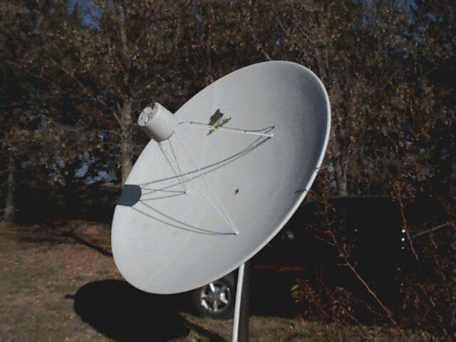

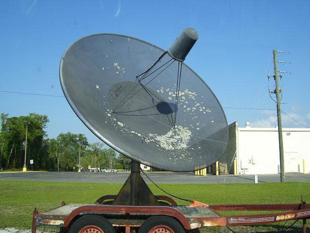

1. White Solid Aluminum Reflector or one with holes in it? If holes, 2 peice design?
2. Is Dish NOT over 10.5 Foot?
3. 3 legs holding the feedhorn to the dish, with 2 legs on each point?
4. Mount on the back has a half circle on top or bottom?
Dish one and two are birdviews

Cosmo is a very well built an great playing dish, an they also had a H to H mount that was very nice to (Von Weise motor), as well as you could get it also with a polar mount. Cosmo has been known for their 3-leg feed supports that are highly adjustable. back in their day was a very costly dish to buy. think they stop production about 93.
Cosmos made a 10-1/2 and a 12 foot antenna, based from a factory near Medford, Oregon, between about 1984 and 1989. Excellent performing sectional type antennas. They made a marketing agreement with Chaparral Communications to sell their antennas under the Chaparral name. Unfortunately something went wrong with that agreement and they ended up in a court dispute. Cosmos won and was given damages, but the drain of time and resources was too much for the owners, who decided to exit the satellite antenna business completely. It was ironic that they had just completed a much larger manufacturing facility....but decided to take the money and get out of the industry.
