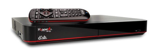

Or, you could simply install your Hopper 3 like this:
(Yes, I am still making fun of Solid Signal's upside-down Hopper 3 picture.)
The box is a box, which has 6 sides, each with energy it wants to transfer outside. So all six sides should have the ability to transmit the energy to the air... and not another surface, as the surface isn't going anywhere, while the air will flow around the receiver, transfer a bit of the energy and go away and dissipate it.
