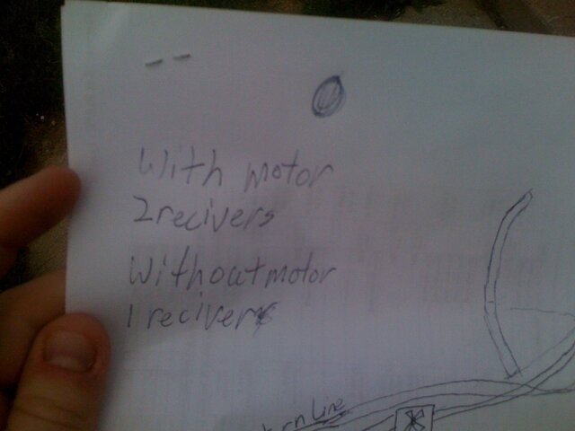

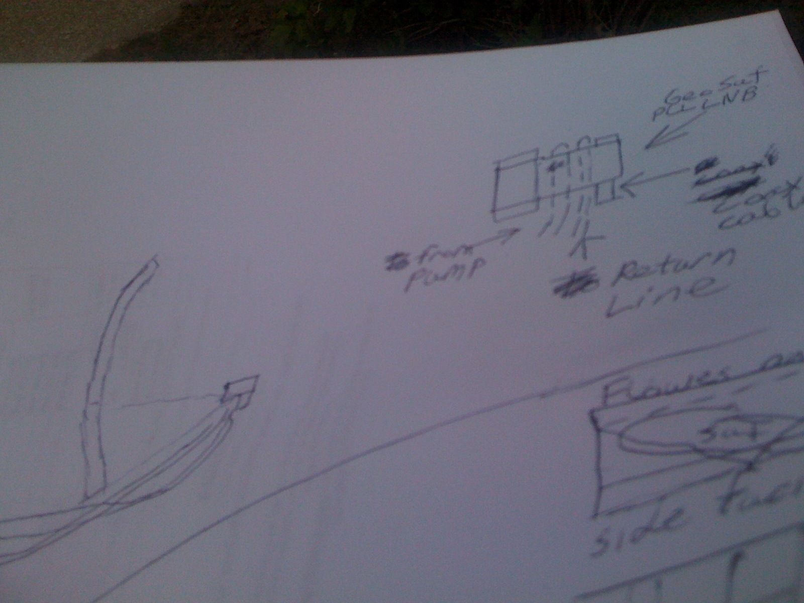

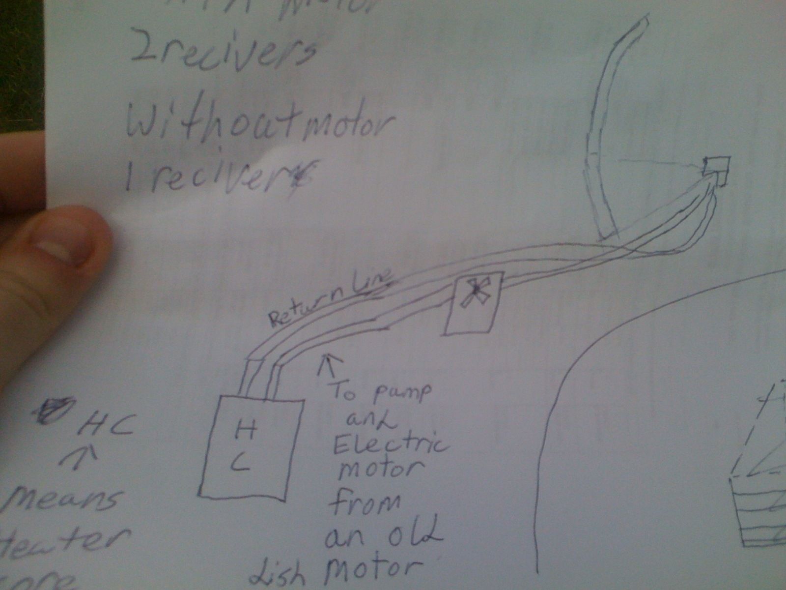

here is my idea on how to cool the geosat pro pll lnb. IMG_0068[1].JPGIMG_0069[1].JPGIMG_0070[1].JPG sorry for the bad hand writing use a heater core from a 1987 dodge charger should work it can be controlled by your receiver insted of depending on an out side power source. Plus mike and wally I got cozi tv to come in its not a bad channel to watch.

Cool man. Are you going to build test sounds like a cool idea.
I was thinkin'(Oh-Oh ???) a little more technical. A thermoelectric generator module (tegpower.com?) feeding electricity to a solid state cooler(http://en.wikipedia.org/wiki/Thermoelectric_cooling).
But why? Is there thermal issues you're experiencing. The last time I had real 'thermal issues' was a 15 yr old LNB that would just up and quit if outside temps went above 80-85 for more than an hour.
I would concentrate efforts at achieving performance gains to chill a LNBF to sub 0 degrees Celsius. Reducing the ambient operating temperature to a consistent 50 or 60 degrees would help a DRO LNBF maintain a more stable LO frequency, but would yield little performance gains.
Are you trying to lower the noise or increase the stability?
Cooling it to sub zero and maintaining a stable temp will lower the noise and increase the stability but at a very expensive cost. A quality DRO will have a better stability and lower noise without going to the work of improving the geosat.
raising the temperature and maintaining a stable temp will increase the stability and lower the phase noise a tiny bit but probably increase the gain noise, but much cheaper. But still nothing a quality DRO cant outperform.
Quality DRO's can maintain 150khz stability easily, there are even some that are better. a DRO will always have a lower phase noise then a PLL. If you need sub 1khz stability (satellite tv can handle 100x worse no problem) then you jut dont have any options, and a PLL is the only way.
Its a fun project, but your not really going to see alot of gains for the amount of work your doing.
Now if you take a high quality DRO and cool that, now you can see some gains. There was an interesting article I read years ago, cant find it anymore, I think it might have been in tele-satellite about cooling a DRO
