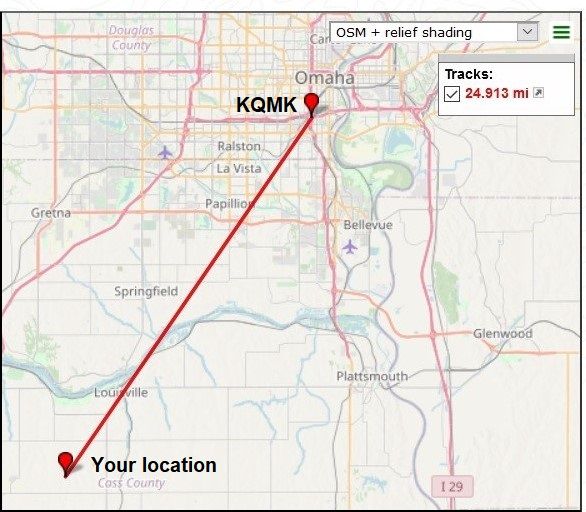

I'd like to get KQMK-LD, physical channel 21, virtual 25. Please reference RabbitEars.Info . My working antenna (see complete setup below) is pointed to the NE and I am picking up physical channels (listed in order of field strength) 26, 29, 22, 20, 31, 12, 32, 17, 15, 33, and 35. Channel 21 has a field strength less than 33 and 35, and is in the same general direction. I thought I should be able to pick it up. However, when I look at fccdata.org the station is in a different location on the map: FCCdata.org - powered by REC
There are two locations in fccdata.org. The most recent matches with rabbitears.info, another site marked as pending shows the Ashland, NE location.
Sorry I don't know how to interpret FCC application data. Where is the station right now? To the NE or NW?

The FCCdata.org shows two locations. The one dated 07/07/2020 lists the correct location which is:
Latitude: N 41° 13 ' 29.6 "
Longitude: W 95° 57 ' 10.5 "
or
41.224889, -95.952917
As a double check:
RabbitEars.Info
click on Application Info
Application Search Details
click on View LMS Information for License
click on View Engineering Data for coordinates and antenna data
It's to the NE and further away.

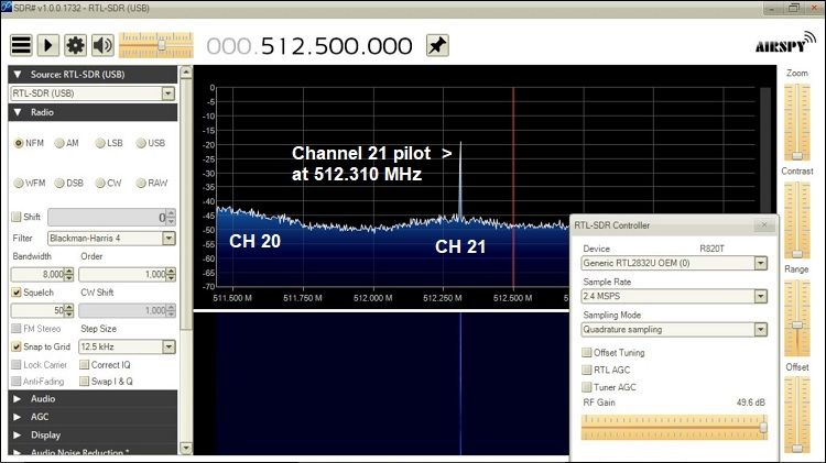

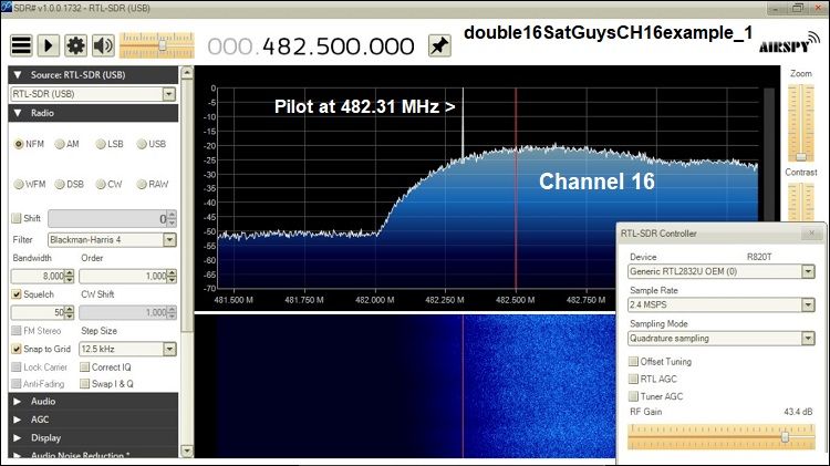

If I was at your location, I would want to see if I could find the signal using a $25 USB dongle and SDR# (SDRsharp) software.
Channel 21 is 512 to 518 MHz. It's pilot carrier is at 512.310 MHz.
double16satguysch21pilot_1-jpg.147971

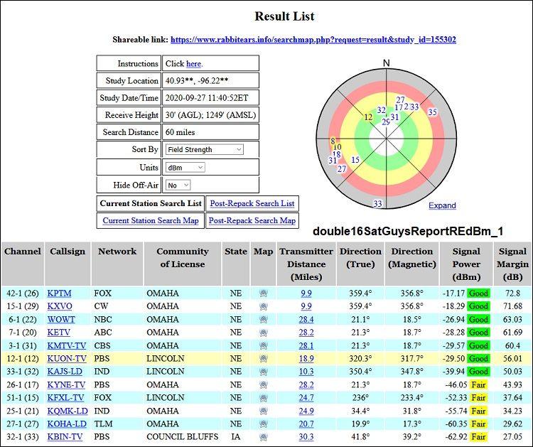

Need some more help here. Short version is I'm pretty sure my signal issues are that I'm overloading the tuners. I had thought I needed more gain. Currently my best SNR numbers are with my Five Star pointed AWAY from the stations, into the combiner, then the pre-amp. The combiner only has this antenna. The other input is open (I've learned this is probably a no-no).
I connected only my RCA with it pointed at ~40 degress, no combiner, and many of my SNR levels dropped and I lost KAJS-LD which is ~10 miles from me. (I'm using an HDHomeRun HDHR3-US scan). Then I tried my Five Star Yagi only, no combiner. Same, SNR for most stations in the <75 range and no KAJS-LD. I pointed it towards KAJS-LD, nothing. I played with the setup for 2 hours (on top of a 50 foot tower, pretty comfortable with it now ;) I pointed the antenna away from the stations, it got better, added the combiner and most stations are SNR of 80-95. Except KAJS-LD and KBIN.
As for the station I'm originally trying to get KQMK, I've had some progress with the current setup. Whereas I was never able to get a lock, now the live bandscan sees it off and on throughout the day. Last night it had a decodable signal for a few hours.
I'm thinking getting signal from the back of the antenna will have issues, like more susceptible to atmospheric events? (guessing on that). I'm more hopeful now I can get KQMK, KBIN, and KAJS reliably. The other stations are pretty strong and I don't have much issue. Am I thinking correctly that I'm overloading?
What I think is the right thing to do is to point the Five Star Yagi towards 21 degrees at KQMK. The rest of the stations are in the general direction or have a very strong signal. Take the combiner out. Attenuate the signal. I'd like to attenuate after the pre-amp because it's in the house. Possibly I'll get better quality signal aiming the antenna the correct way. Below are the signals I care about.
The Wineguard LNA-200 has a gain in UHF of 18db and NF of 1db, the antenna gain is 12db. The max input signal to the LNA-200 is 126 dBuV if the mV to dBuV calculation is correct. So probably not overdriving the pre-amp, but close. That means I should be able to attenuate after the pre-amp.
Another concern is that there are two very strong signals on either side of KQMK, 32 and 34. Would those bleed over? Anything to do about that? I guess if it bleeds over at the antenna/pre-amp I'd have to attenuate between the antenna and pre-amp. :/
Advice is appreciated!
Answered my question: the pre-amp is overloading the tuners. Turned off the pre-amp, took out the combiner, pointed the Five Star to ~20 degrees to get both KAJS and KBIN since those are the two stations I want with weaker signals. Levels look ok but could use some boost. Still no KQMK. I have attenuators on order. I'll try with pre-amp + attenuators and see what happens.

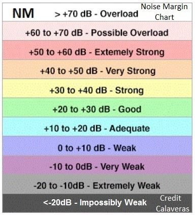

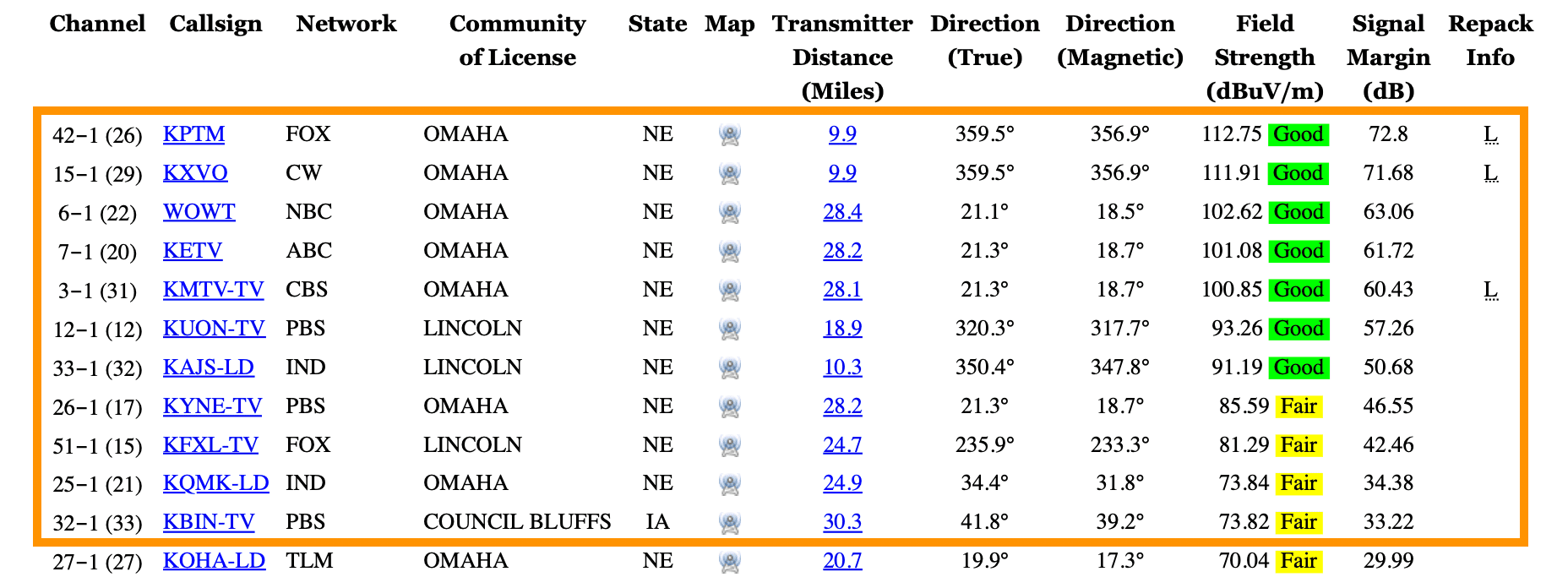

That's quite possible. The Signal Margin on a rabbitears.info report is similar to the Noise Margin on a TVFool report.
If the antenna is aimed at 21 degrees, WOWT has a Signal Margin of 63 dB. If you add the antenna gain of 12 dB, you are at 75 dB, which is considered overload.
Listing the signals in your report by dBm, WOWT has a Signal Power of -27 dBm. If you add the antenna gain of 12 dB, that brings you up to -15 dBm. The MAX UHF input of the LNA-200 is -26.7 dBm.
The preamp and the tuner would be overloaded.
