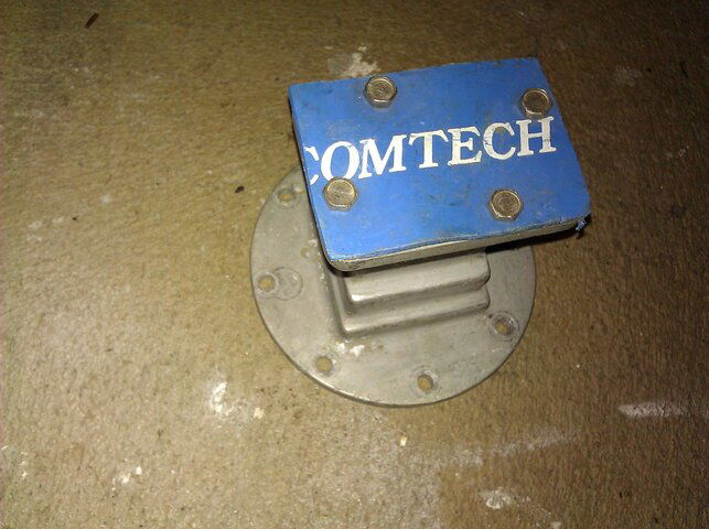

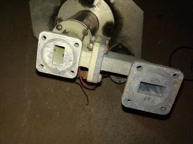

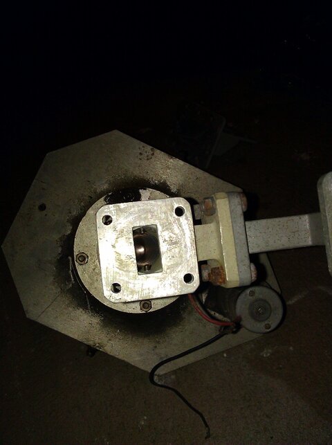

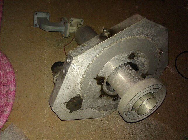

I have no idea what these extensions are for this feedhorn setup. I am also not sure where to get LNB for the Ku side of it. I think someday I would like to use this for Ku just to see what fringe signals I can pull in with it. Can anyone explain what these adapters are for? I don't have a manual and everyone I talked to at ComTech is clueless about this.

Definitely save the Ku feedhorn adapters - you might want to adapt these to a Channelmaster or Prodelin feedhorn if the round flange is C120 pattern.

In pic 3 you just see the round flange of the "waveguide" held on with 4 screws. That could be C120 size like for the feedhorn of some Ku dishes. Yes, convert the part that goes from round to rectangular to another dish for Ku only.
The "waveguide" is what conducts the microwave radiation to the LNBs You have 2 rectangular openings for LNBs at right angles to each other, IF the pattern is the same as for something like a Norsat 4106A LNB(or Eagle Aspen 770 KU). The square bolt pattern/waveguide size for these LNBs is WR75.
That square flange is like a little over 1 inch square. It is pretty small. I will have to take some measurements and see what I can get. Do you know what the angle adapters are for? It has a motor on it to adjust skew so I think I will just run one. The guy I bought the dish from said he used the dish for uplinks.
It's a KU orthomode feedhorn and scalar with adjustable skew. You would put two single polarity ku lnbs on it. One would be vertical and the other horizontal. Two cables to a multi-switch. You don't really need the adjustable skew working to use it.
Thank you for restating this.
Yes he would need the adjustable skew - the dish doesn't have declination to compensate for azimuth, if he uses that waveguide with the Comtech dish. But, using 2 LNBs for H&V & the multiswitch would allow fast polarity changes.:)
