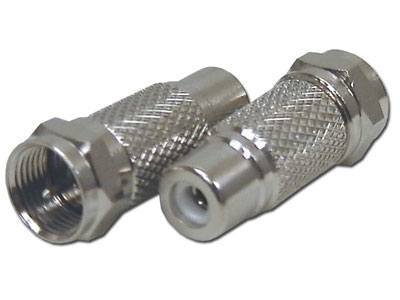

You would be much better off with a good grade of rg6 coax with "F" connectors on it. Adapters can then be screwed on the ends to convert them to RCA males.
If you buy them from Radio Shack, you can just return them, if they don't work.
I cannot use Coax as there are NO coax outputs on the HR20's ...

I cannot use Coax as there are NO coax outputs on the HR20's ... Jimbo
You can use RG6 and adapt the end to meet your connection needs. RG6 is just a cable; you most commonly see the "F" type connector; many people just say coax, but you can have various types of connector types.
