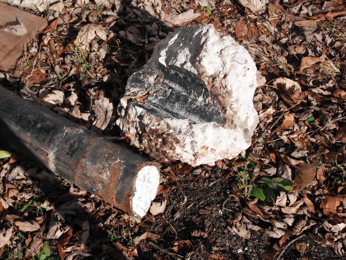

At first I thought hitting concrete with a small handled hammer was futile. Then suddenly a big chunk broke free from the pole and the chase was on. In this case, though, the goal was only to get below grade. Pizza cake.
By the way, sawing off a pole filled with concrete presented no problems. Concrete doesn't add any strength once the iron skin has been breached -- the pole was a pushover.
Concreted BUDs, you're on notice. Resistance is futile -- especially if your pursuer has power tools.
