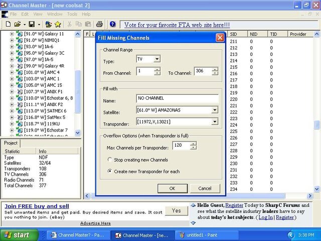

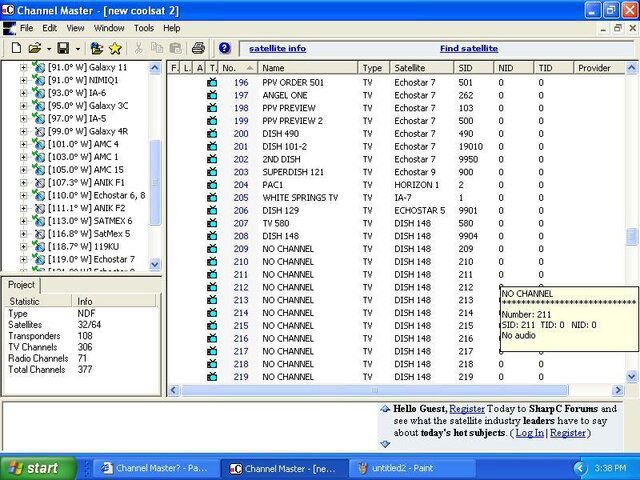

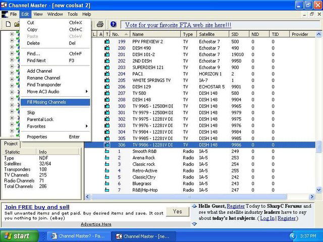

There is an option to say "fill in the blank channel numbers" but the drawback is it shows "no channel" then in the list

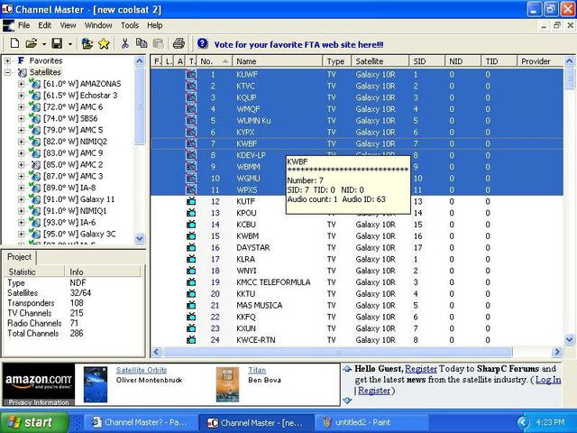

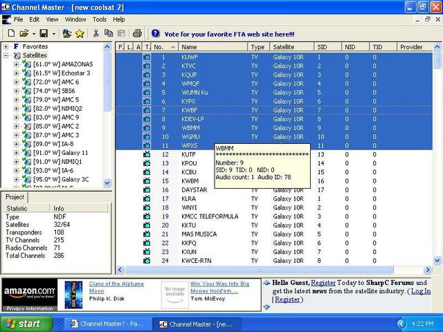

see attachments below

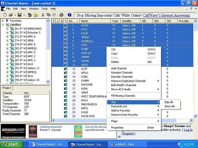

Thanks! I wasn't sure what that option was for. I'm still unclear on how to use it. Does it create blank channels to fill in the channel number gaps? IOW, if I start my actual channels at 101, does it create blank channels for 1-100? Can they be set in bulk to "skip", so that I do not have to deal with them when using channel up/down on the remote? (I'd hate to have to set each one individually.)
yes it puts "no channel" in the gaps. As the example I posted, I put the free stuff on 148 at channel 300 and used the "fill in" for the rest between 200-300
yes
I honestly don't know. never tried it
