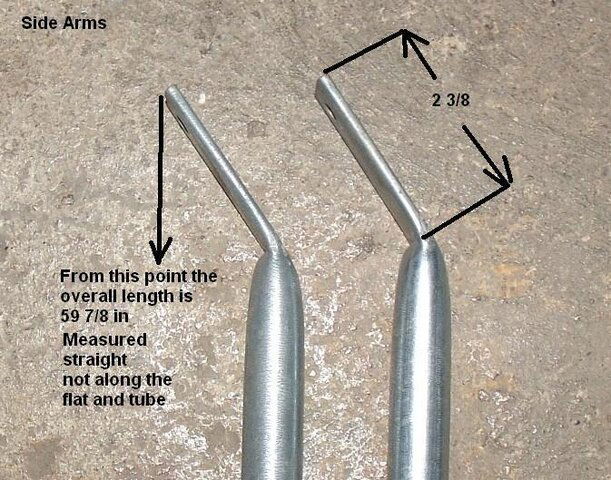

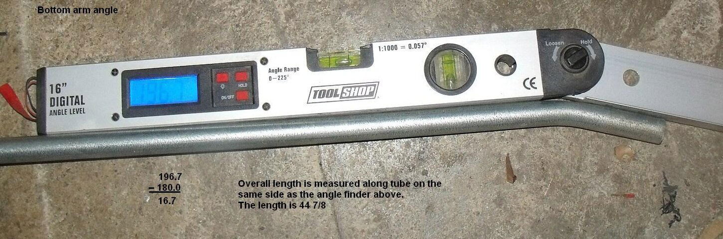

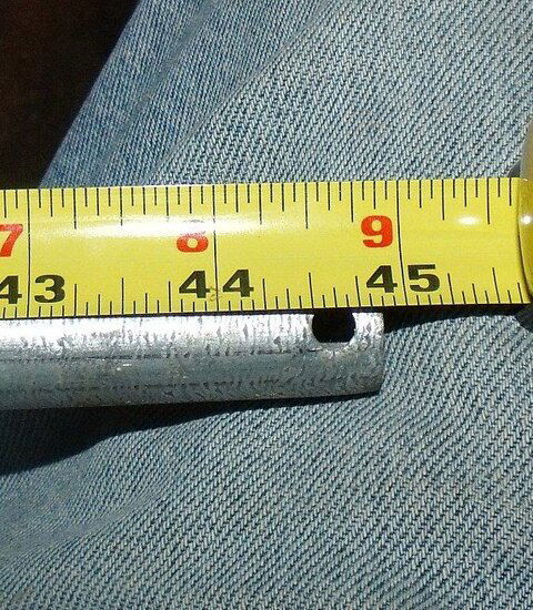

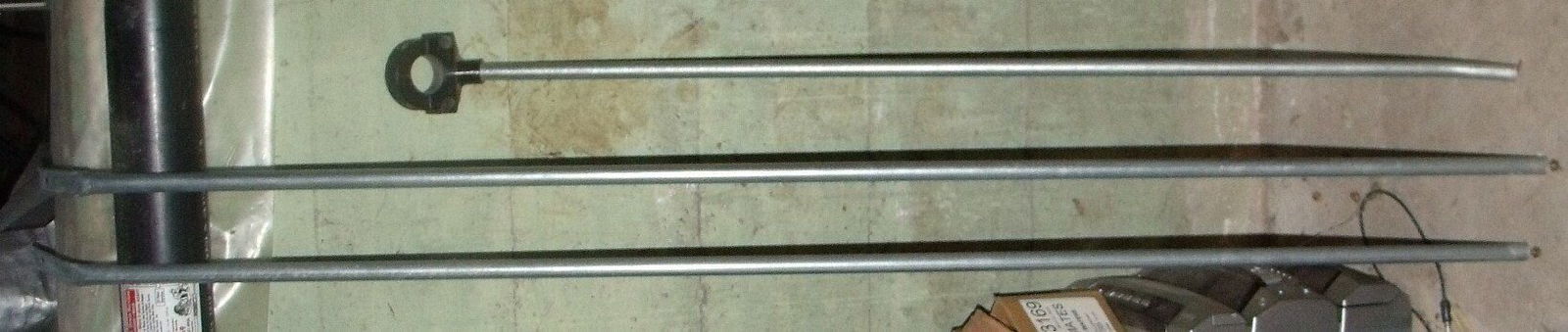

Here's what I have. If your sidearms are identical, and the rest "looks like a match", this should be it.
The pic with the tape is the bottom arm length.

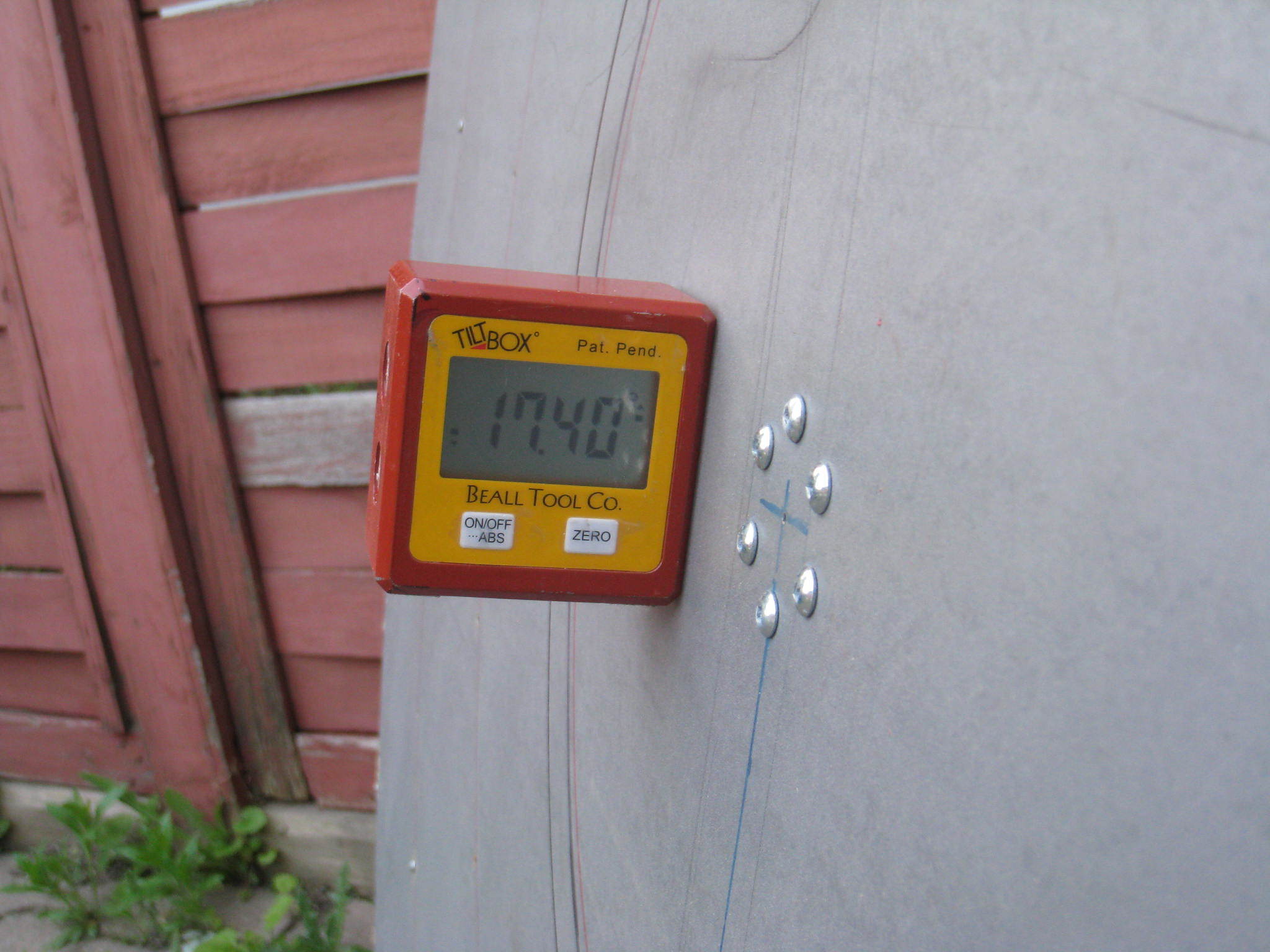

Wait......
That tool in the second picture..
attachment.php
Am I right to understand that that thing gives a read out of the angle of something on the digital screen?
If so, how much are these dandies and where would one find one??
Thanks! :)
Wait......
attachment.php
Thanks! :)
This device was bought in Toronto, Canada, from Lee Valley Store, and I paid about $ 45, if my memory serves me right. Other similar levels could cost about $ 20 to 25 in US, I believe.
>>that thing gives a read out of the angle of something on the digital screen?<< That's all it does.
It's not a level, just measures the angle between the main body and the arm. 0 to like 290° or so.
Think I paid about 25 bucks for it a Menards.
My digital level was a bit over 50 at Sears. But that CUBE level looks quite a bit more versatile. Would fit into tighter quarters, to say.
Ok, that's what I was thinking it did. I have a tilt meter, it's a dial with a needle and a magnet, nothing electronic about it, purely mechanical. But all it does is tell you how much something is tilted.
I saw the gadget and assumed it was for telling you the angle that something is bent at.
With that, one could replicate missing dish arms, just like the original poster was looking to do.
I have a 6' Prodelin/Andrew/CM "0179-189" dish with mangled arms that I'll need to make new ones for. This gadget would be a huge help. It may be the same or very similar dish as you guys are talking about.
I sure hope so because if it is, this is the jackpot for me!
:D
