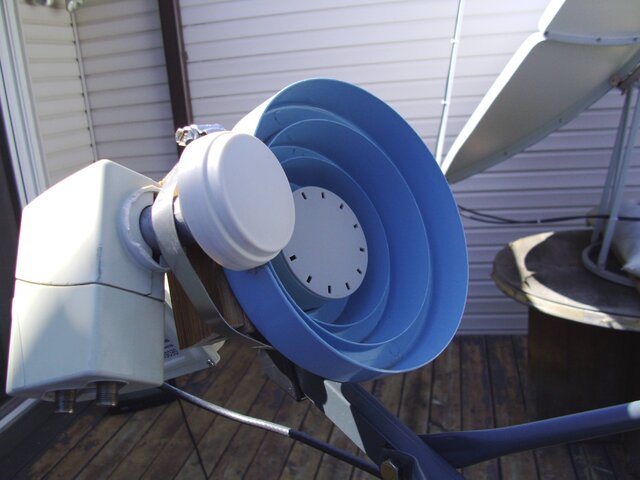

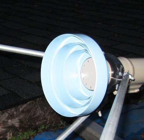

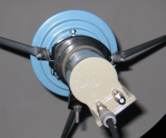

One odd thing I found is that I had to turn the LNB to line up the 0 degree marker in the back horizontally to get signal on 99W. Please see the picture. I would have though that the 0 degree marker would be pointing up.
To see the pictures of the original Ku LNB, please see the pictures here.
Any suggestions?

On those LNB's for some reason the skew seems to be 90 degrees off. I have 6 of them (2 different brands) and all skew 90 degrees off so "0" skew is at 9:00 or 3:00 as you showed

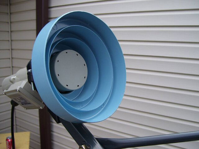

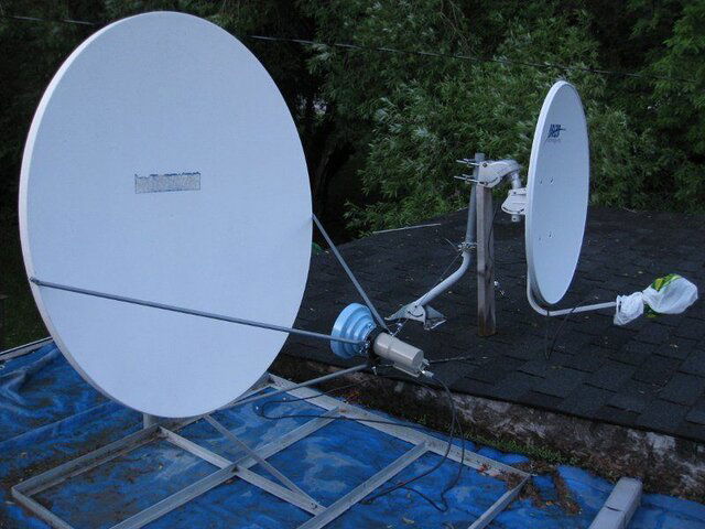

I also learned to push in the LNB a little bit to gain signal (see pics but your mileage may vary)
I tried this, but got less signal. Found that mine gets the best signal when the scalar ring is flush with the edge of the LNB. I also tried without the scalar ring, but got less signal. The scalar ring makes a huge difference.

Actually, all I did was I made two small angle brackets with holes in them and put the in between the two parts of the LNB bracket with the bolts going through the holes of the LNB bracket and angle bracket. This dish has no LNB arm, just 3 round tube braces, so I bolted the bottom of the LNB bracket to the bottom brace, and the other (side) braces to the angle brackets.
interesting....I never had good results with it flush
