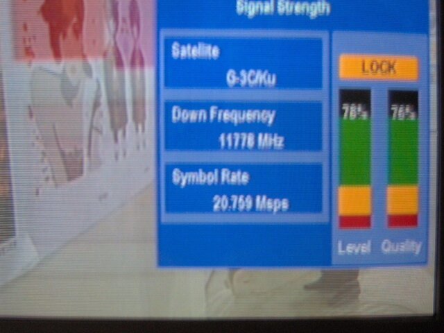

most receivers you can press the info button and it shows it
couple examples are enclosed
