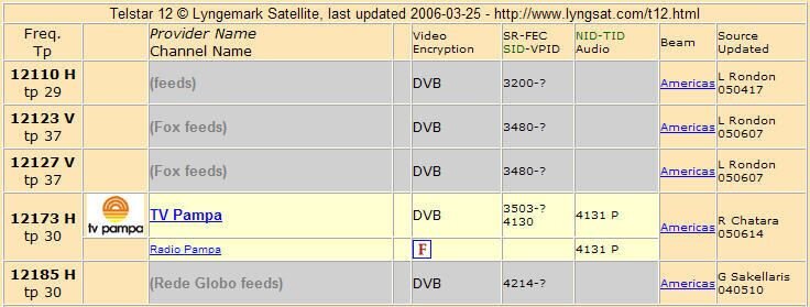

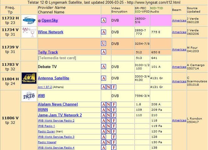

Here are some screen shots of what up there on T12 according to Lyngsat , sure would be fun to get some of these channels.
