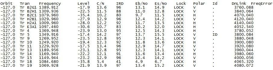

Wow!! I'm impressed so far! Better reviews coming from multiple people aka Me, KE4EST and Joe. Just wanting to get something up.
This pop scan is from 127 C-band.

What size dish and how many of those transponders were you able to lock before with the old lnbf?

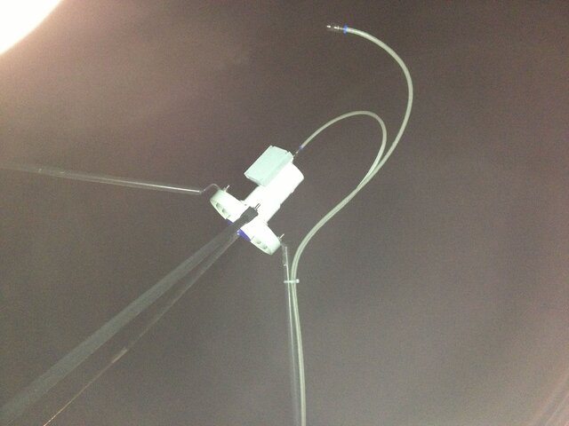

10 foot sami
All but 4065
Using a different scalar ring "chaparral"

What is "pop scan"?
Its the scan feature in the AI turbo S2 that makes life easy because it scans all TP's and puts in one file :)
That 4065 is weak compared to other TPs on that Sat. I have it locked at 8.6 S/N & -40dBm with second-hand Norsat 3220 PLL on 10ft Unimesh.
POP= Proof OF Performance Used by installers to show the dish was properly aligned when the job was completed. Some customers can't leave well enough alone :)

Still under the weather, but this is what I got off of 99W and my 1.2 Meter dish today.
That is helpfull. Stronger across the board. Might not help pull in any transponders you don't already get but will give you more margin in poorer conditions. With a small dish you need all the help you can get. Do these numbers also reflect using the new scaler as well?
Yes this is with the new scalar, forgot to mention that. Next week I hope to get some results off of my 10 footer, but I just didn't feel like climbing up there today.
