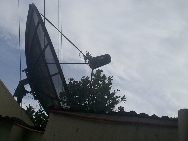

i got 2 satellite signals 1 sat dish.

Bravo Agers. Could we get a front view pic? Are the two sats Telstar 10 and PAS 7/10?
I will do same when my dish up.

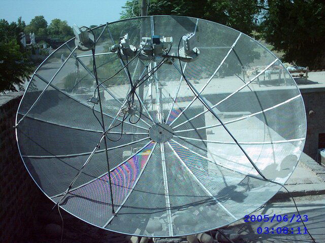

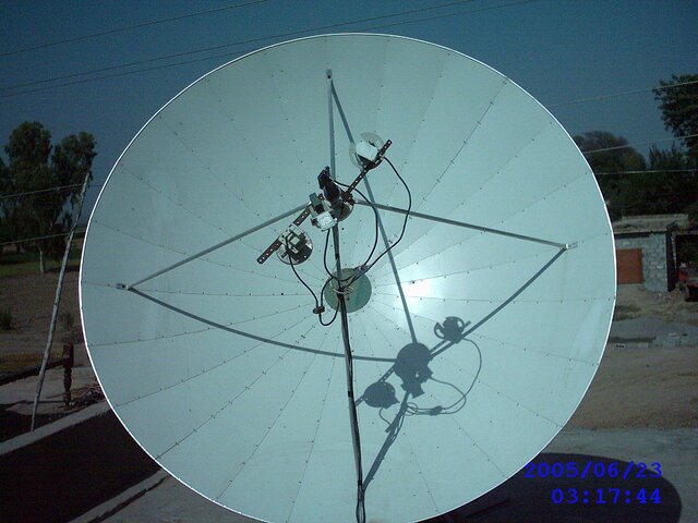

See what this guy from Pakistan has done. 7 lnbs on a dish. Very encouraging pics
That would be the "same" satellite and not the adjacent one?
Is quality of the signal the same on both?
Nice picture!
signal quality 90%
signal level 70%
both satellite signals telstar 10 c-band & intelsat 7/10 c-band.
