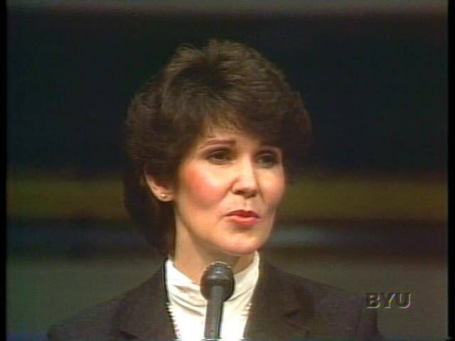

Here in Sacramento area with 36" dish / Invacom QPH-031, no problem!! I'm getting 69% on CoolSat 5k.
