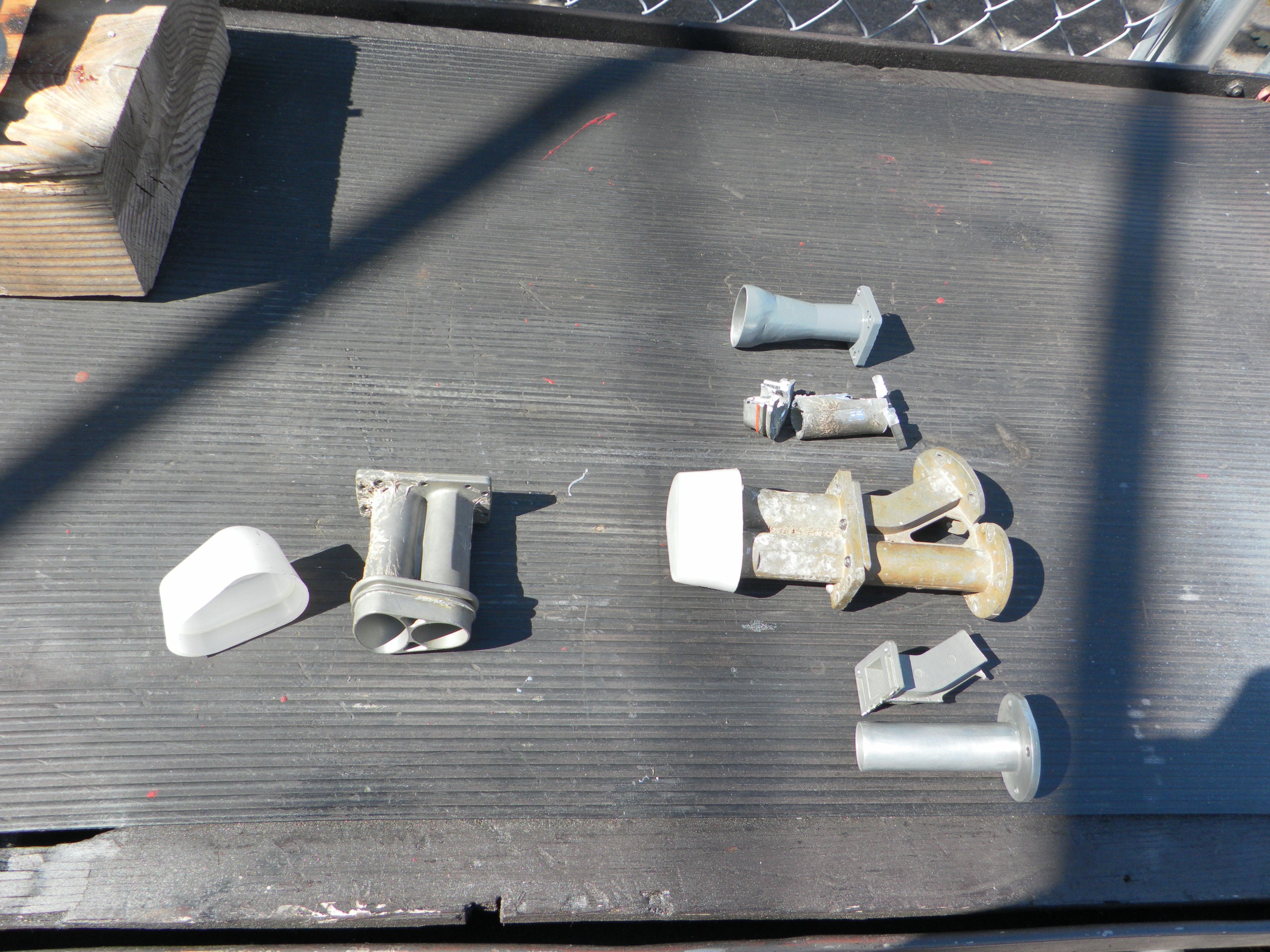

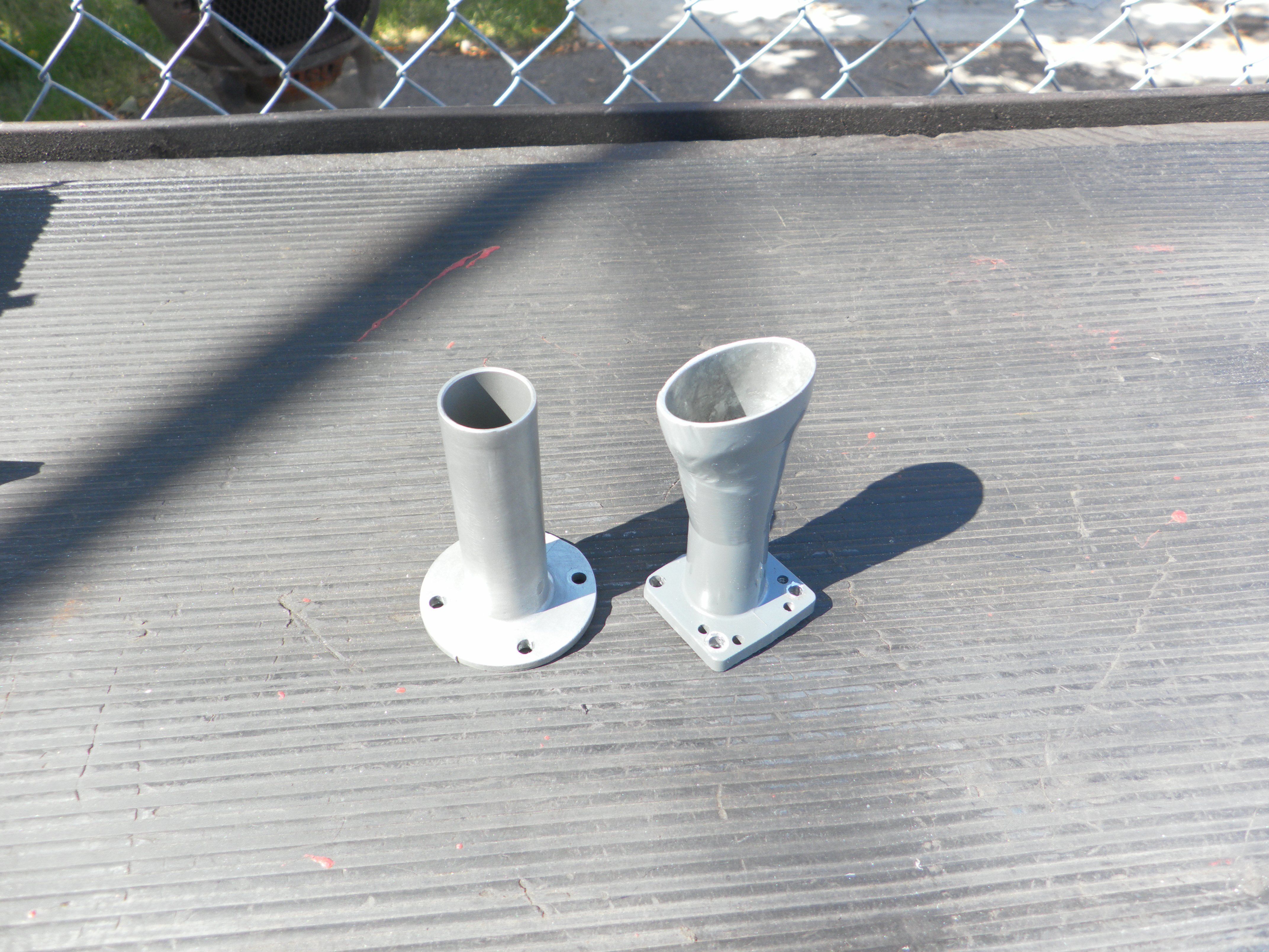

I carved up the LNBF from a 121 SuperDish and cut out the waveguide section for the 119 sat just for that exact same purpose.
thanks Magic
seen pendragon do that too but i don't have a SuperDish and they are going for $70 on e bay yuk.
the ADF-120 feedhorn seems to be going for <$15 more than just buying the lnb alone.
