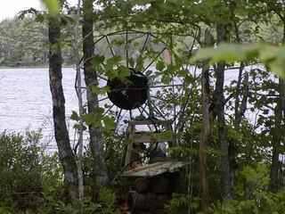

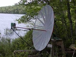

Here is a dish I made out of plywood and mosi screen. It was an experiment to produce a large light wieght dish that the wife wouldn't think was an eyesore.
It was a success from than point of view as it was very hard to see with the light behind it.
As a Ku band dish it wasn't great it was 48" but performed like a 33" dish, not really sure why, the mesh size was 1.5 milimeters which should have beem OK for Ku, the accuracy of the dish shape left a bit to be desired which may have explain some of the lose in gain, also it was prime focus so the LNB was in the way of the incoming signal.
It weight in at 20lbs with the mount, so I had 6lbs to play with and still be in spec with my SG2100 motor.
I dreamed up a method of making the ribs out of laminated wood and shaping them on a jig with a router, this should make it even lighter and keep a better shape, just haven't had time to try it. I keep getting messages about finishing the house from some one. :D

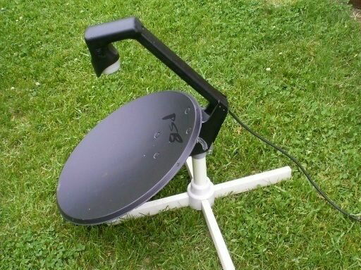

And very easy to make, the below dish is made with a sawn off fan stand! EXACTLY the right diameter to fit the Dish :eureka
It could be placed on the floor in front of a south facing window!

:) The dish is simply inverted, upside down! Its a circular LNB so it will work in any position.

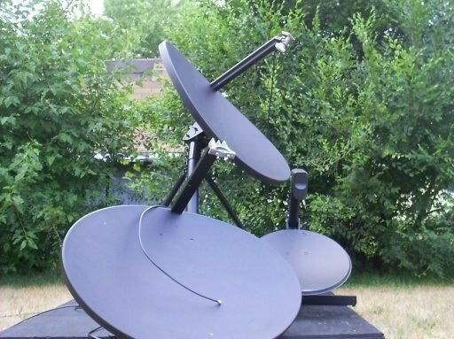

Most of my dish are upside down to keep them low and out of sight as much as possible! Even a linear LNB will work this way!
