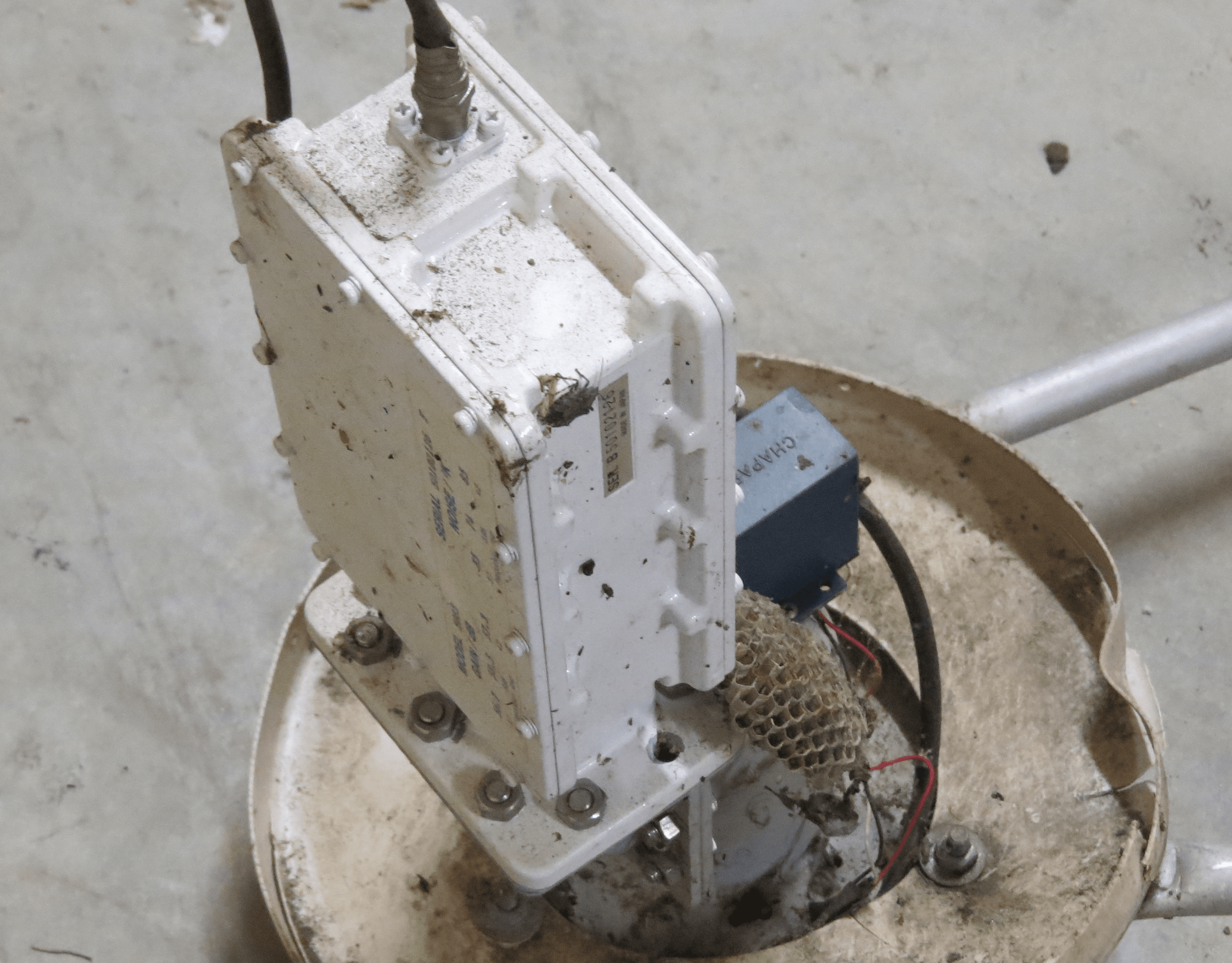

Also, I took the cover off of one of the LNBFs. Inside I found a living beetle (visible in the photo), a camera shy Black Widow, and a wasp nest. I released the beetle into the field behind my house. Anyway, I can identify the insects but have no clue what brand of LNBF is in the photo and if its any good or not?
Looks like an old Gardinar or norsat LNB. There's a label on the side, #'s?
Its a 'Model 5085' Serial #B 50102126. Made in Japan.
