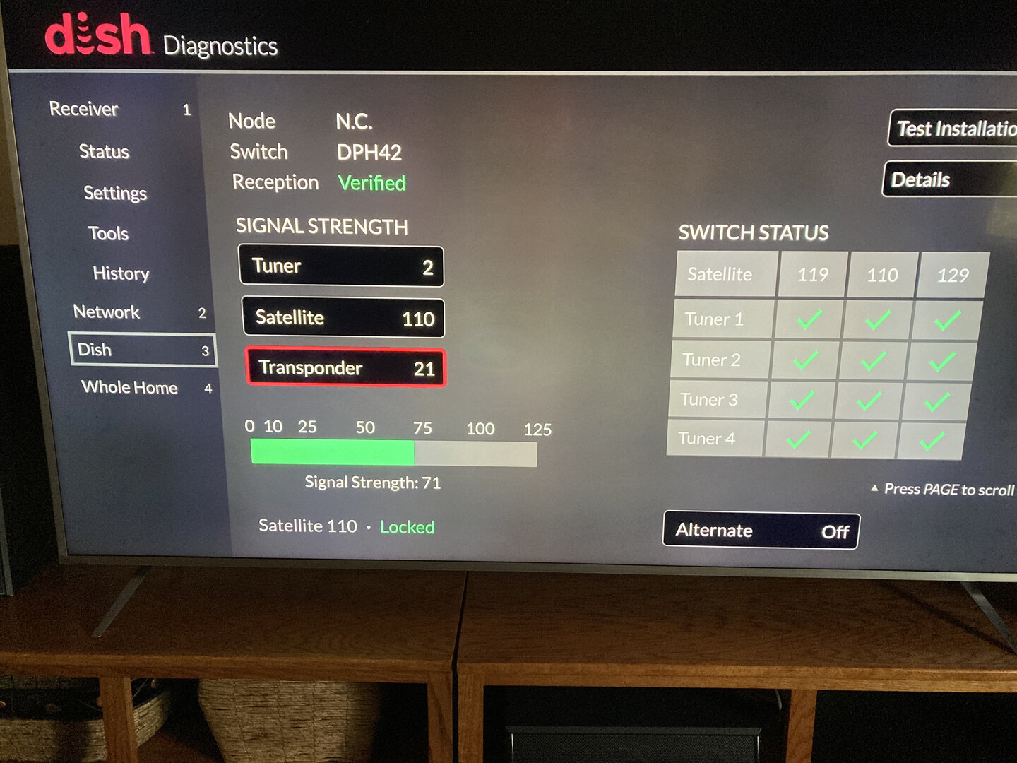

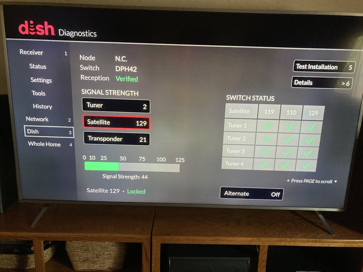

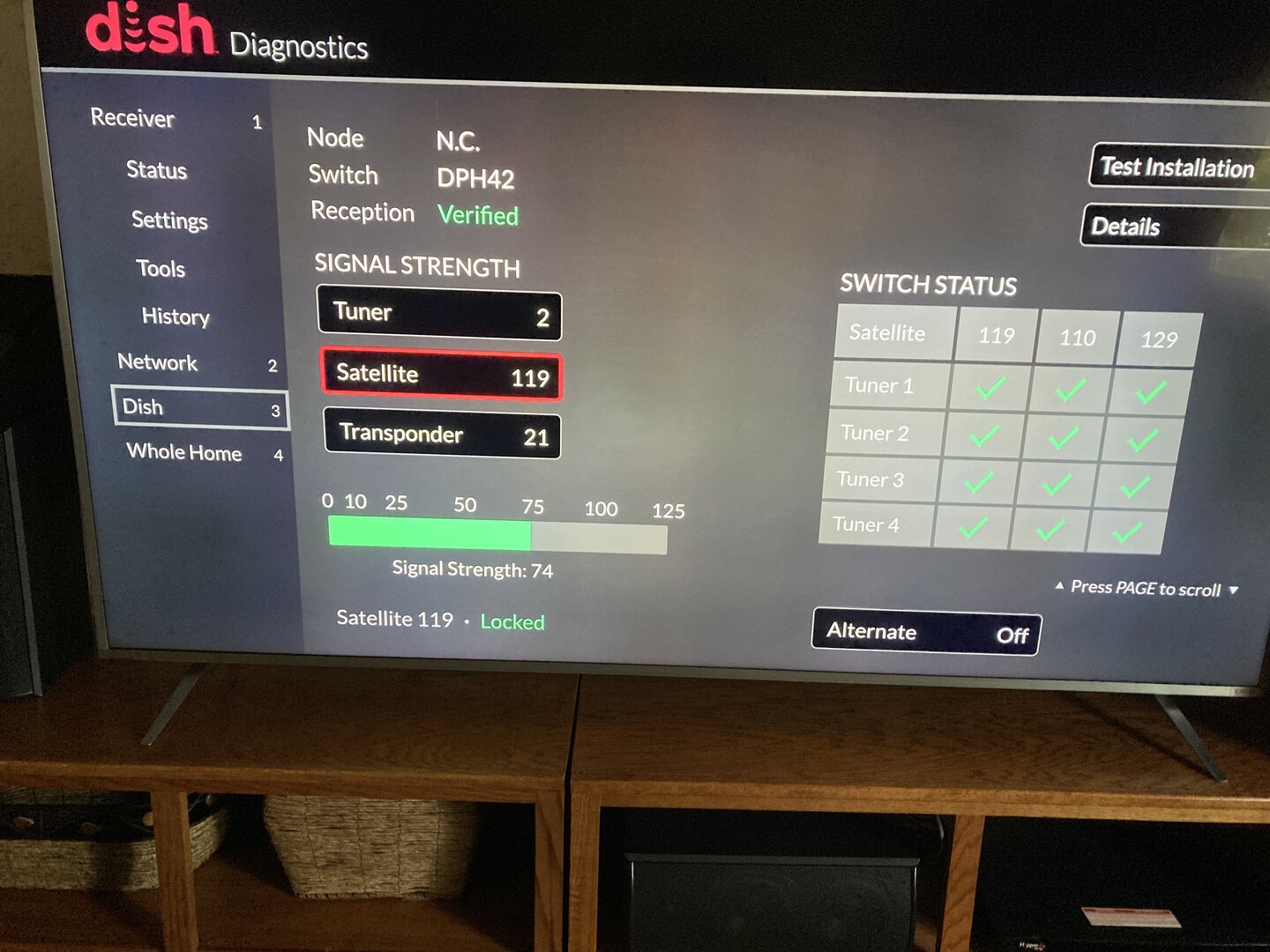

I am a bit concerned that you are showing 63 on all 3 satellites. 129 is never, and I mean never, as high as as 110 and 119. Here is what I get here in the SF Bay Area:
You will note that I used transponder 21 on all three satellites. That is because they are not spot beams, they are CONUS. Now you will also see that in each case it shows the satellite as Locked. That is very important. If you were looking at say 129, transponder 21 and you should see Locked as well. If your equipment wasn't seeing 129 you might get a signal that looked like 119 but it would not say Locked. Go back to your Hopper and try it, go to each satellite and move to transponder 21 and let us know what the signal strength shows and if, in each case, it shows locked. Also ensure that you are seeing the correct Satellite at the bottom. ie: my last photo shows Satellite 129 . Locked... The satellite chosen under Tuner should match the satellite at the bottom.
