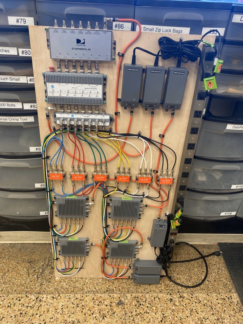

88 Room Best Western I'm working on.
Just finished wiring the DRE board today with (4) DSWM30 switches
All the wiring is home run, just have to replace the 16 way splitters with a combination of 4 and 8 way splitters to plus into this board.
Or I guess the pertinent questions would be will all the boxes in the 88 rooms be HD receivers (H25s?), or some with DVRs (HR24s)?
And as the resulting spaghetti mess of cabling in one of the photos shows. Why would that Hotel choose "Homerun" topology from the backbone instead of the much more sensible, cleaner, and less expensive "Loop-thru?"

Yeah all HD, all H25's
Home run wiring is always better than loop through.

I think Directv's support of loop-thru was for hotels that already had wire and splitters in the wall and didn't want to rip everything apart. If you have home run, why would you use loop through? If you had the walls open for remodeling, why wouldn't you do home run wiring? That gives you the greatest amount of flexibility, and while it costs more if a hotel is remodeling the cost difference of loop thru vs home run will be lost in the noise compared to how much they spend remodeling bathrooms, replacing carpet, upgrading sprinkler systems and so forth.
Yes, the support of loop through was for older hotels. Even if you do loop through DRE, you still got to replace all the splitters, taps, wall plates and fittings.
To be honest, the places that have loop through wiring the wire is in such poor condition it's rarely done.
First of all most if that garbage is RG59. Then if it is RG6, you can't crimp a new connector on it because the wire is too short.
Then you got the issues with fitting the tap in the box and then you got to find out where the loop starts and ends.
It's easier just to put in a com3000 digital headend and leave the existing wiring alone, or rewire everything.
You really don't want to mess with loop anyways, because if there are any issues your going to be going back out there for free to try to fix it.
It's bad enough we don't make enough money on these large jobs to begin with. We can't afford to eat the cost of a rewire.
Usually on a loop through we will quote it as a com3000 if they have proidium televisions, or quote it as a rewire
