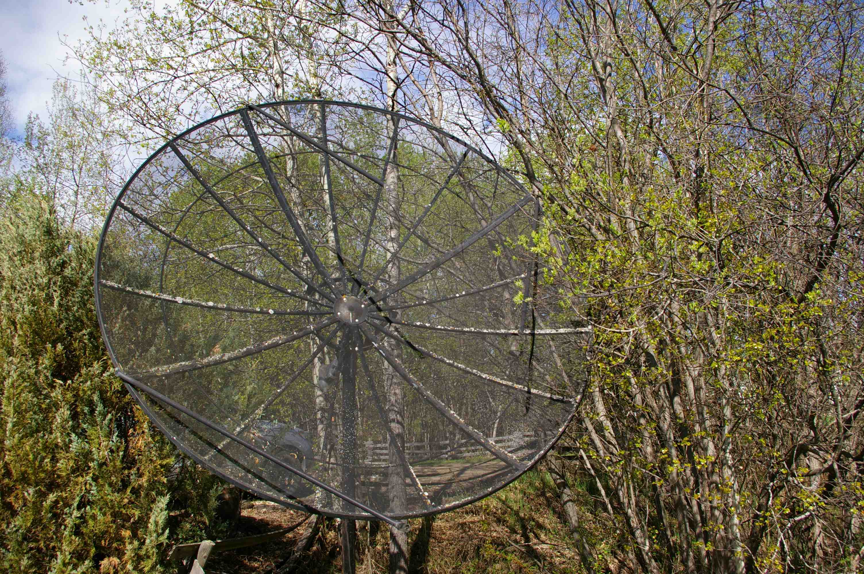

10 foot mesh dish with a Global Image logo on the feedhorn cover, and same logo on a blank serial number sticker without any actual serial or part numbers.
Mesh in good condition on all panels except for one with a dent. Dish hadn't moved in years - the white that you see on the dish in this picture is surface lichen. (Picture 1)

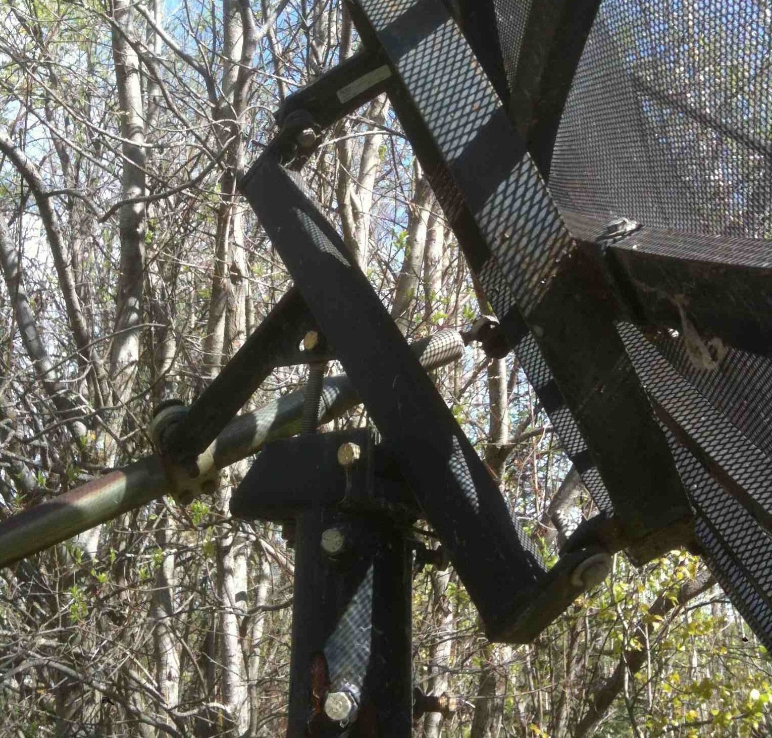

Sleeve is rusted but we were able to spin the mount, detach and remove the dish, then lift all of the other hardware off the post intact. To my untrained eye this looks like a nice clean method to attach the dish to the mount. Steel laps over two ribs then is through bolted. (Picture 2)

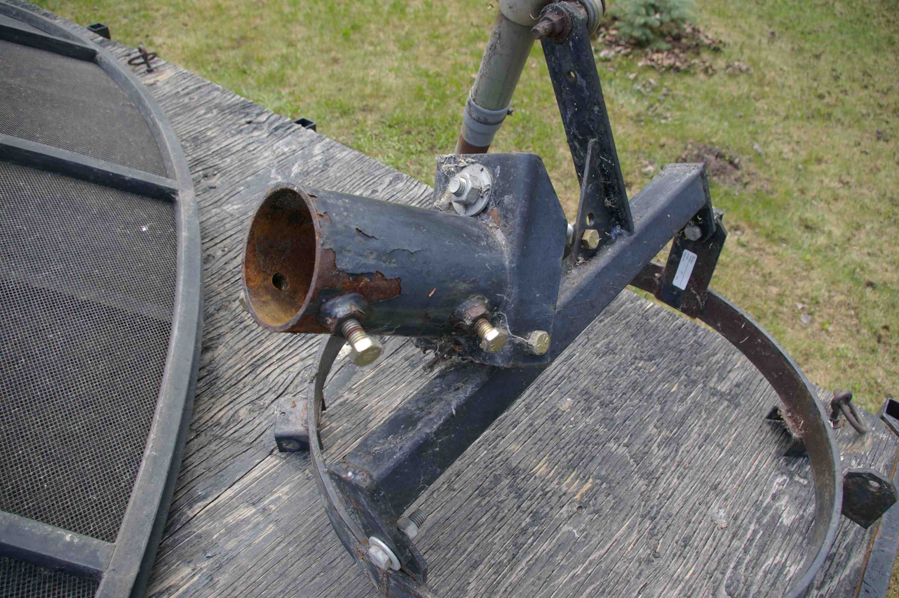

The sleeve for the mounting mechanism has some surface rust, mostly under flaky paint. Looks like it can be cleaned up OK. (Picture 4)

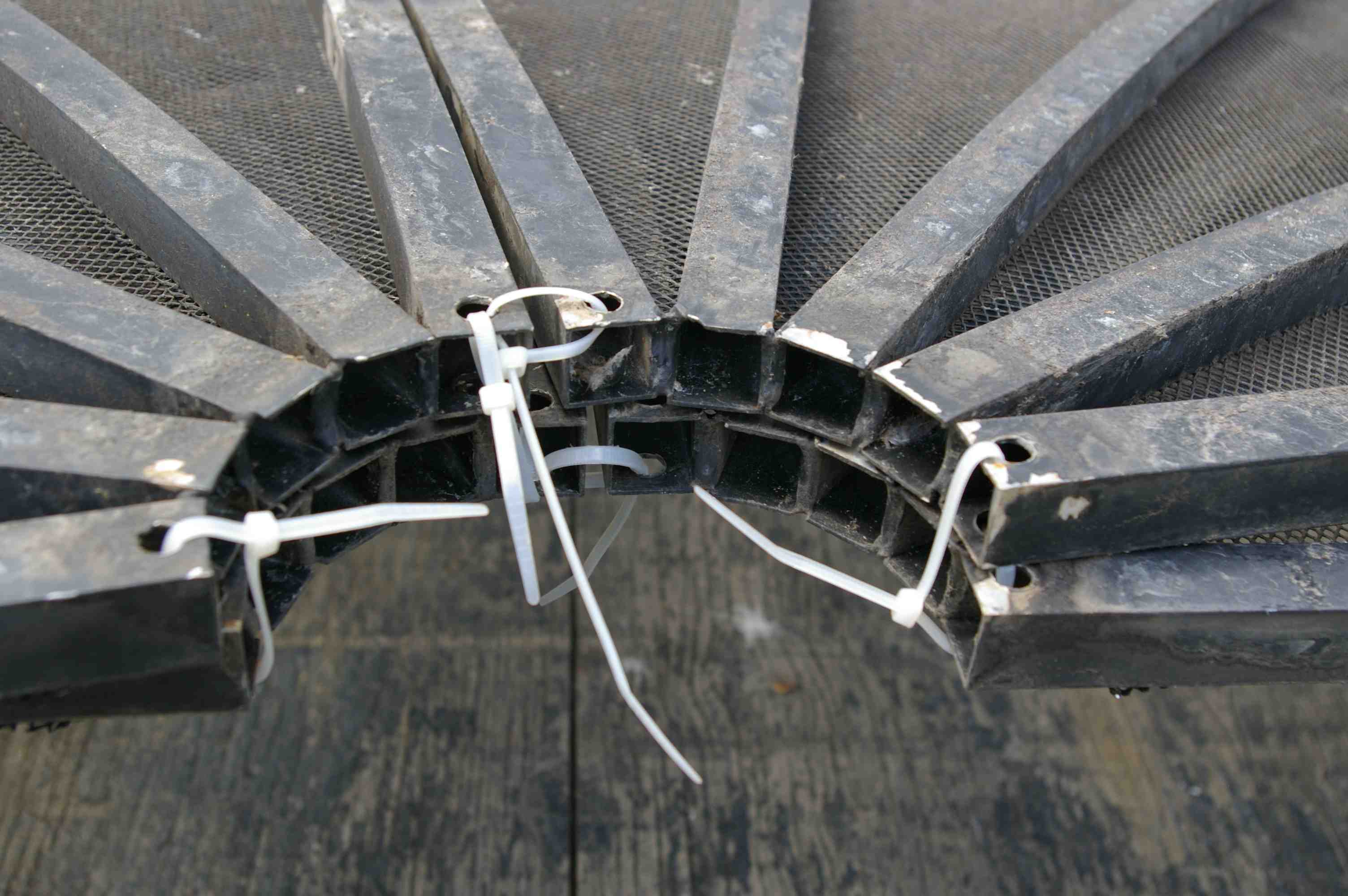

Broke dish down into two halves for loading on the trailer, then nested them and zip tied the halves together so they didn't bounce around too much in transit. Dish would break down completely into four quarters, you can see in this shot that the ribs have been tacked together at the centre. (Picture 3) This method needs only four carriage bolts to tie the front and rear plates together at the centre of the dish, as opposed to one bolt per rib on the 12 foot mesh I grabbed on the weekend.

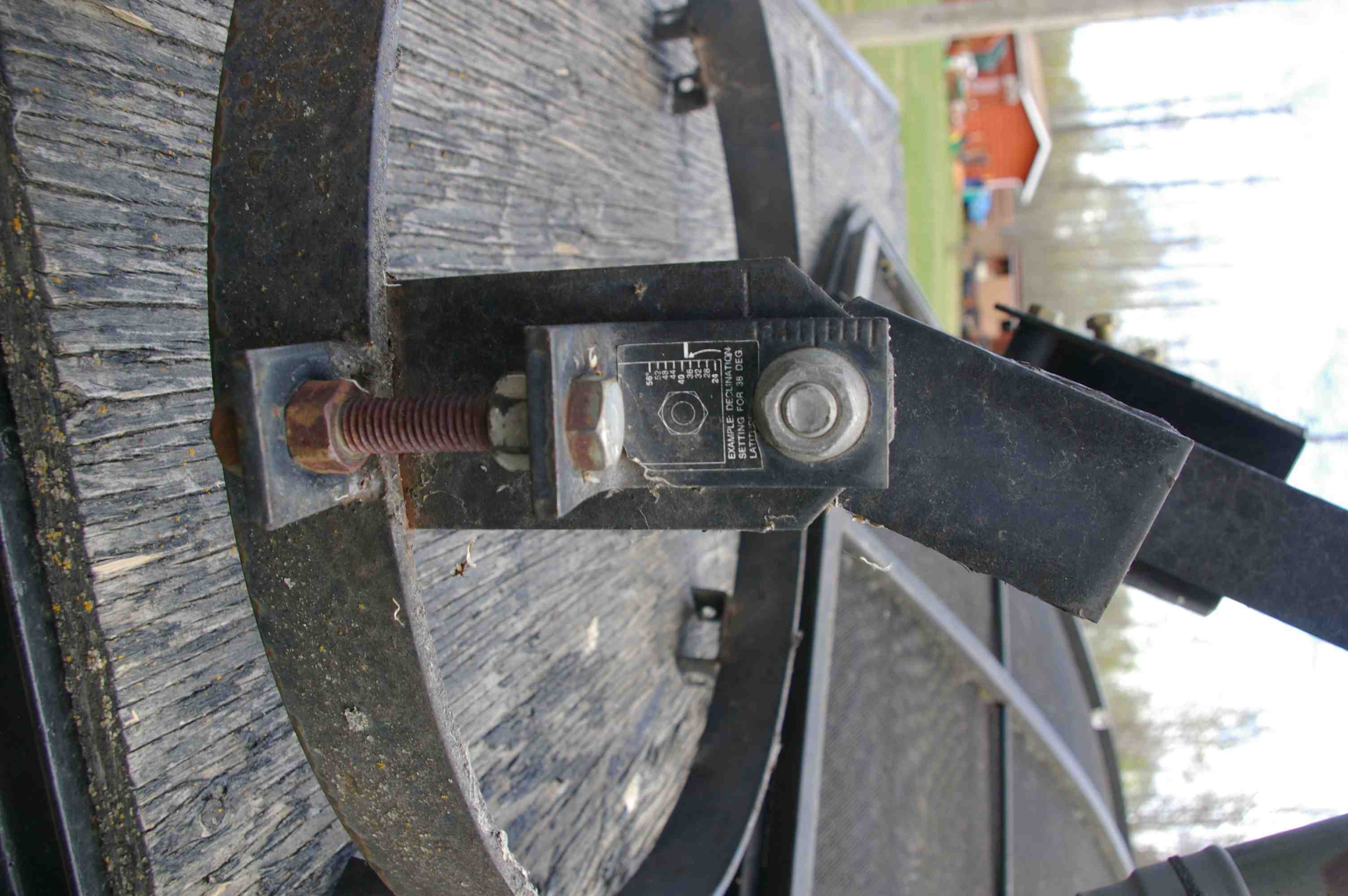

I also like that with this dish I have some reference marks to use which might help for aiming. (Picture 5)

Nice find. I must've missed out on the ending of the 12' dish story-I'll look back for it. Hey-you're motor is on the wrong side of the mount! LOL

Even though the motor may be on the wrong side, I'll be happy if I can hit from 87W to 107.3 - 147.4 to 171.5 degrees True from my location. :-)

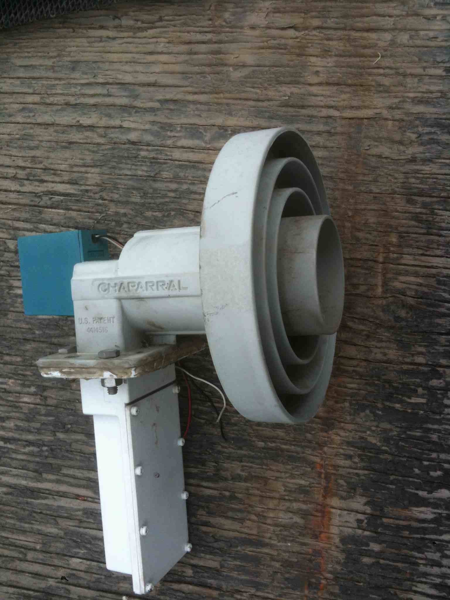

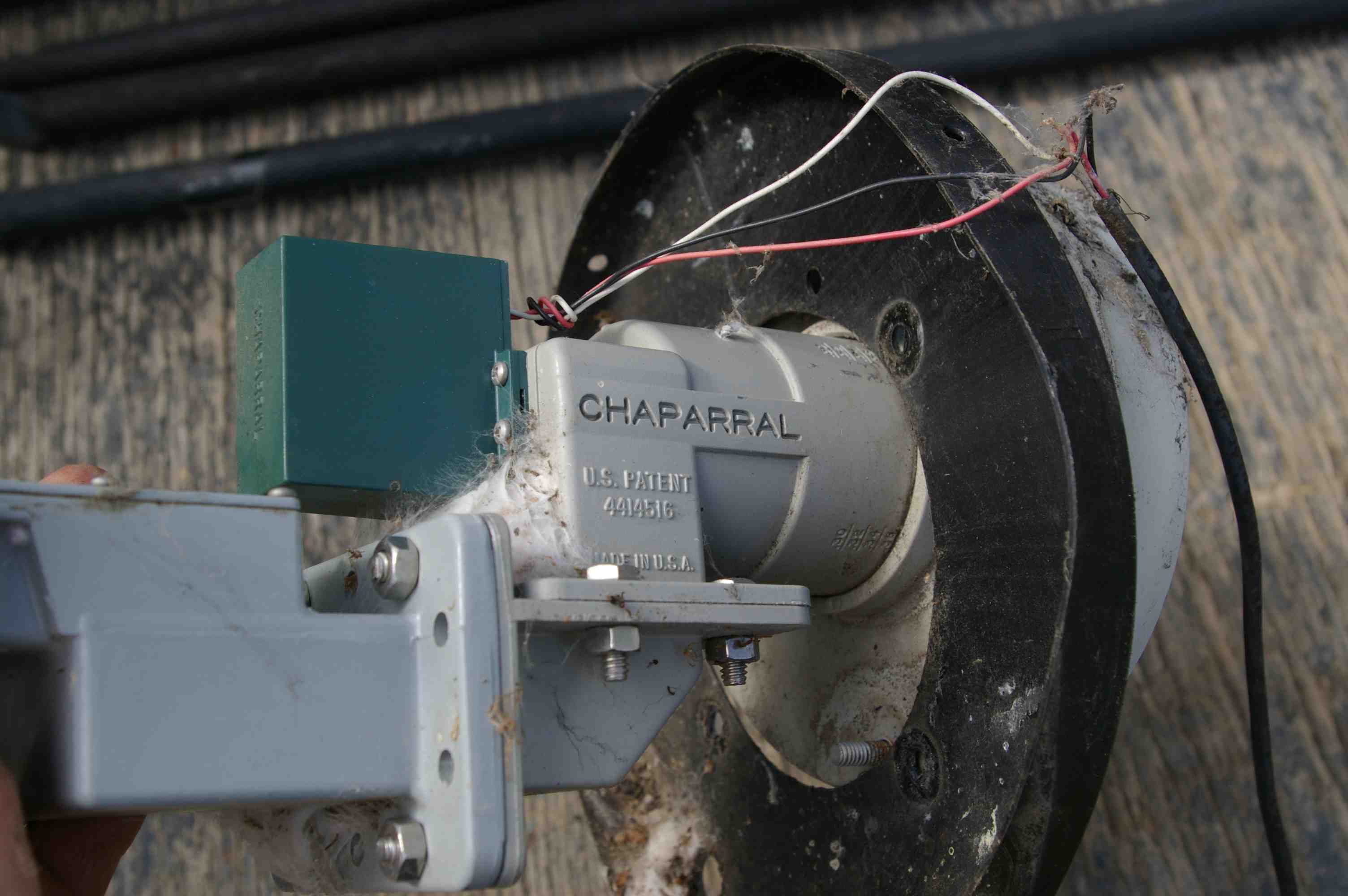

The two motors I've picked up look similar to me. I have not cracked open the first one, the second one had a pop bottle covering the connections.

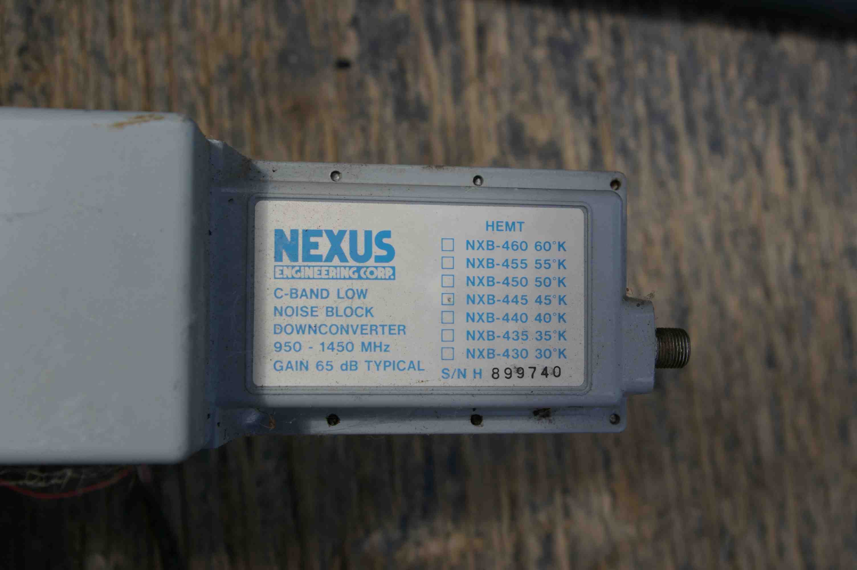

The LNBs are both Chapparal, could not find any part number info on the first one.
Second one
The center plate on this dish is the same as my new Channel Master. Those center plates are unique. I would bet it's a CM
I noticed that.
I wonder if ChannelMaster would have been the actual manufacturer of the frame, or if both companies might have used the same subcontractor.
Maybe "back in the day", when the run rate of new dish installs was really smoking along, someone could have done a good business just cranking out components.
Many regional Ma and Pa dishes were simply part by part copies of a popular dish design. I remember one shop in the NW advertised the fact that their parts were completely interchangeable and cost x% less.
