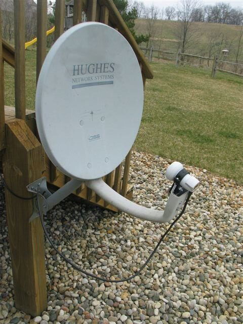

I'm back Stateside and couldn't wait to get started on setting up my dish farm. So found an old Hughes network 50 cm dish modded it with a universal LNB and tried it on AMC9 then Galaxy18 - failed, reasonable signal but no quality. Luckily I have a Satlook NIT so not too much time wasted. At least I got the cable and switches in place. Not bad for 2 days, now to get some proper dishes.
Pix of dish mod below

:welcome BACK TO THE STATES pedrogarcia!!
My My, Nice Pictures Of That 50! GREAT MOD!!

@Iceburg. I got the skew within a 2/3 degrees but I could not even lock a signal on 83 to adjust it finally. On 123 I know I was on the sat as I got the channel list data on the spectrum analyser but quality was almost zero. Have just seen on the forum that RTN may have been down while I was aligning the dish on 83 so will have another go tomorrow if I can find enough coats to wear. I'd forgetten how cold it can get. MTA and Florida Channels locked ok on 87 though.

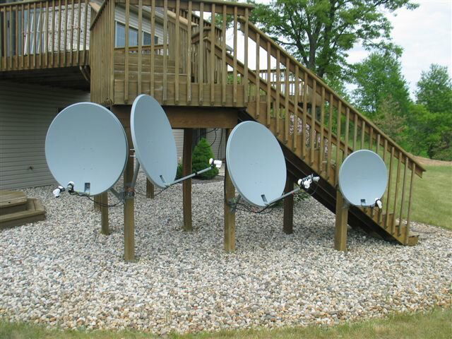

Dish farm update
Back a month now and the dish farm has started. So far 74w, 97w,101w, 123w,125w,129w up and running. Need to get a circ lnb for Nasa on 119w and a larger dish for RTN and C band.
Pixs below.

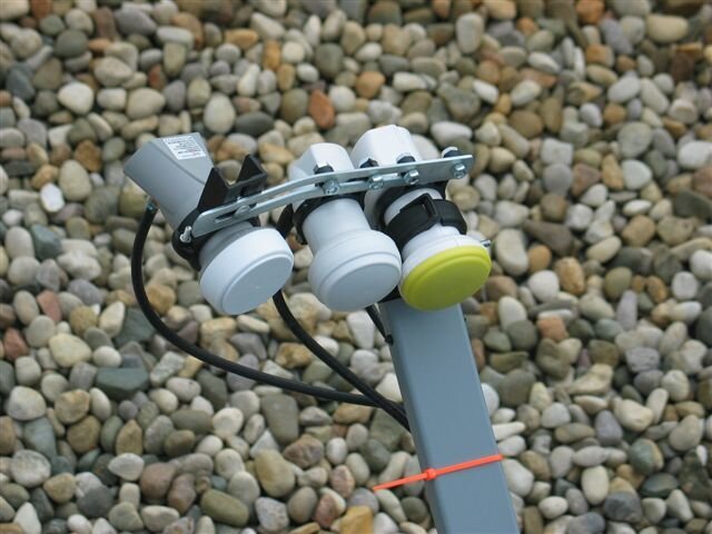

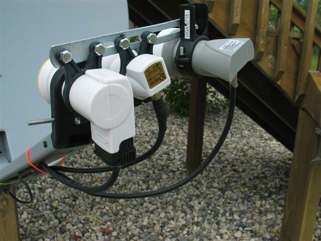

The 3 LNB bracket is great and I have not seen them here in the US so if anyone knows where they are available please let me know.

That hardware is interesting.
LNB arms on the dishes appear to hinge toward the dish, possibly for shipping purposes. Who is the manufacturer?
You can get three LNB brackets here but not like those. The sort of multi brackets in the attachment are common here. (ebay mostly) I don't care for them.

My dishes are from Patriot at Albion, they call them 90 cm dishes but they actually measure 1m x 90cms and yes they come flat packed with the arm hinged. manufacture quality is really good, and they are made in the US. You can collect if you are near enough but phone in advance. I found dish shipping to be really expensive so it was a no contest as I'm only 40 minutes from them.
That euro LNB arm I have used for years, I could kick myself for not bringing more with me, they cost around $8 retail so I'm about to contact my supplier to find a cost to the states.
