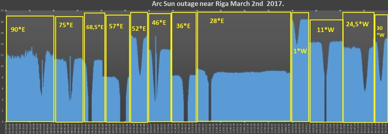

In the past I made some experiments during sun-outage periods. Results of one of them represented on the picture. You can clearly see influence of the outage on different satellites. It was done on base of 1.2m dish. On some satellites it was real drop of the signal till total 0, on some satellites there were considerable drop of the reception. ScreenHunter_207 Mar. 02 22.29.jpg

In the past I made some experiments during sun-outage periods. Results of one of them represented on the picture. You can clearly see influence of the outage on different satellites. It was done on base of 1.2m dish. On some satellites it was real drop of the signal till total 0, on some satellites there were considerable drop of the reception. View attachment 137856

Longitude does not really matters, main is Longitude. So, Sun-outage effect in Latvia is more or less same as people in Canada have. Sun-outage timing in Florida, of course, takes place in different time, but not in May, that is for sure.
