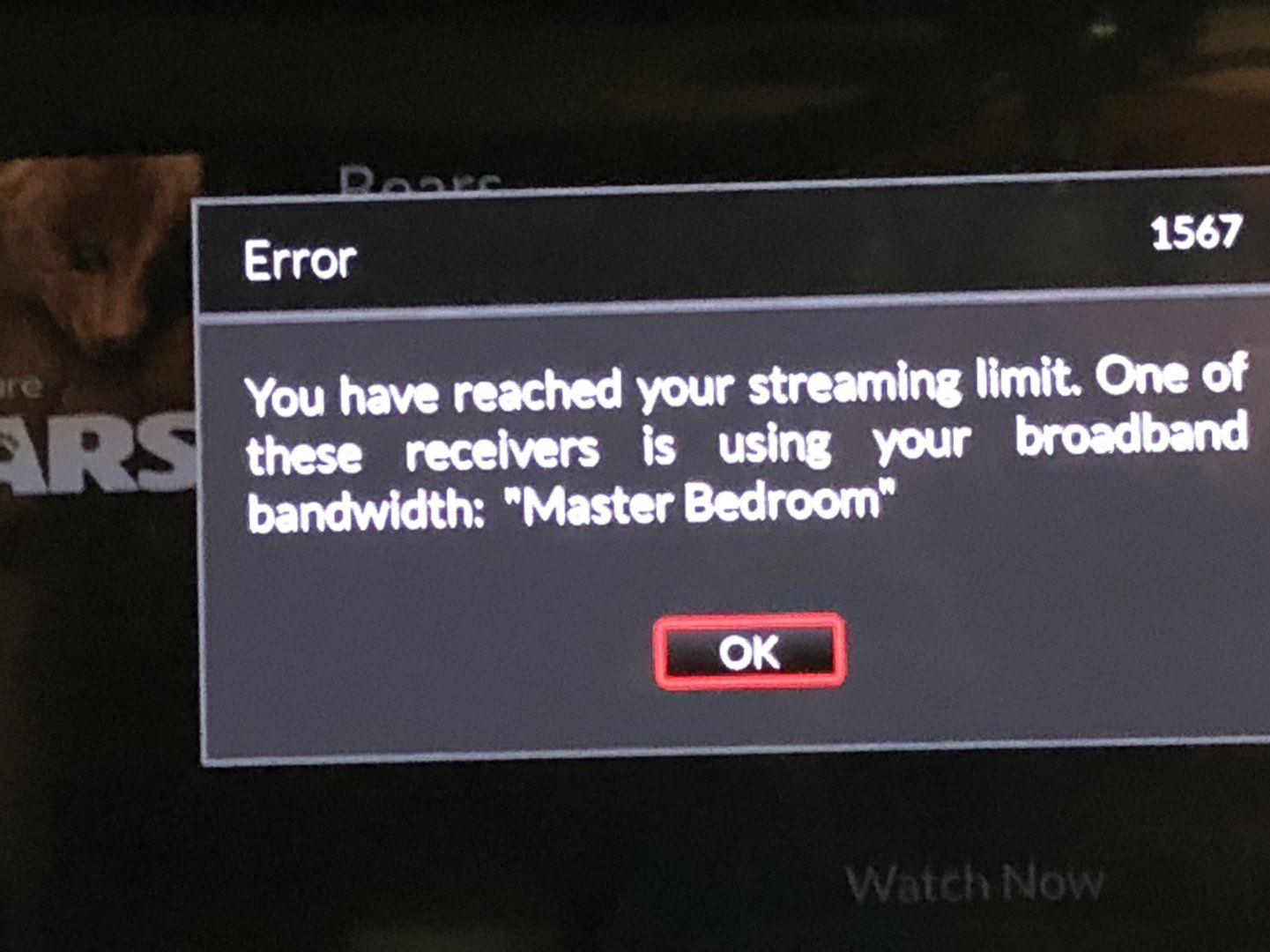

Pat, you are correct in saying that each Hopper3 system can only do one Dish Video on Demand.
I started a VOD on my Joey3 that is connected to my Family Room Hopper3. I then tried to watch a VOD on my Family Room Hopper3. I got the following message:
However since I have two Hopper3 receivers I was able to stream a VOD on my Living Room Hopper3 since the bedroom Joey3 was connected to the Family Room Hopper3 and not the Living Room Hopper3.
Of course you could always select watch later and the VOD will be placed in a Queue and it will be available once it finishes streaming to the Hopper3 hard drive.
By the way VOD from Both of my Hopper3 receivers show up in the On Demand window on both Hopper3 receivers.
