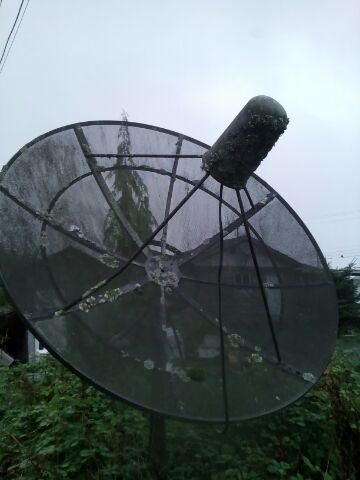

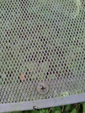

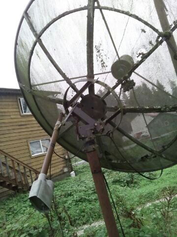

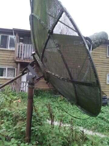

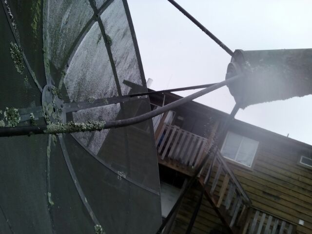

I was there today and found a good candidate - here are some pics. It's a 7.5 foot with a bent rod, but otherwise great shape. The mesh size looks small enough for Ku (is it?) and the moss and algae should come off easily enough to paint it. I don't expect the actuator to work, so if you guys have any recommendations, I'd love to hear them.
Anyone recognise the model?
I plan to cut it down and disassemble for the boat ride back.
IMG_20150909_47911.jpg IMG_20150909_48558.jpg IMG_20150909_49165.jpg IMG_20150909_49638.jpg IMG_20150909_50153.jpg
I can't identify the brand/model but it looks like the mesh size will not prevent Ku reception.
