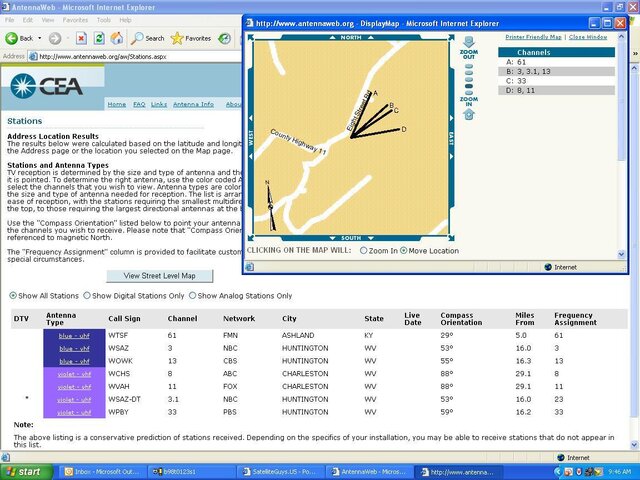

I have been doing prep work for digital OTA and borrowed some equipment while my buddy was moving. He has a Samsung SIR-TS360 DirecTV that I was using for the tuner. Antenna is a new Radio Shack 80 inch VU-90XR catalog #15-2152.
My antennaweb.org information is attached in a jpeg image. (My address is not accurate on ANY internet map including this and I always have to tweak it)
I could get all the networks (3, 8, 11, 13 for me) in digital but they were very weak and I had to move the antenna around each time.
Plan to get a HDTV soon and want to get antenna right for digital only before weather changes for the worse.
So the question is which antenna for digital for my location (I know it is the same as analog but I'm only looking for digital signal if that helps or makes it less complicated.) If I need an amp I need advice and a recommendation on that too.
I have tried to read other posts so I don't waste your time... Thanks in advance.

A lot of factors can affect your reception. If you are looking for an antenna just for digital reception you may want to consider a UHF only antenna. It looks like all of the digital stations in your market are UHF. The last information I could find didn't show WOWK as being up to full power yet. If you were able to get a weak signal for the stations you wanted with the VU90 I would upgrade to a more powerful UHF antenna. Then try to get it as high as possible. An amplifier would help, but you need to maximize your signal with a higher gain antenna and possibly height before that.

You have digitals out of Charleston and Huntington as well as Portsmouth OH, but your location appears to be in a hole. Moving around you with the antennaweb map east about a mile all the stations suddenly become yellow.
Get that antenna HIGH UP there and you just might strike HD.
I'd go for a CM4228 with a Winegard 269 preamp, or an Antennas Direct 91XG with same preamp. Mount a 40' telescopic mast on top of the house and stick that baby WAAAAY up there!
If you get signal, add a rotator for Charleston (East) or Portsmouth (NW).
