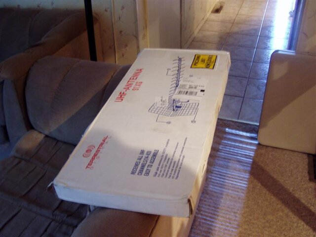

Well I received the 91xg this afternoon.
box wasn't very big...peeked inside.
first impression before putting it together..."you got to be kidding me!"
Used to winegard quality...we'll see. 10 am. tomorrow morning.

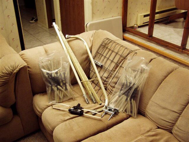

Here are the components prior to assembly.
Notice the active element.
it is facinating how the signal is drawn down the antenna to this point producing the gain.

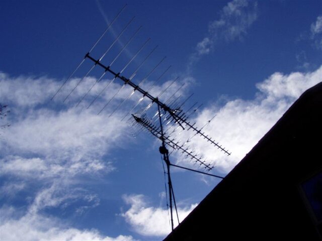

Mission accomplished.
in regards to signal.
compared a station 54 miles away on digital ch 29.
hd8200p 54 signal
cm 4228 68
91xg 83
on a low power ch 14 analog which gives me problems.
the hd8200p and cm4228 were noisy with some snow. the 91xg gave a very clear picture. so the hdtv primer gain figures may not mean a heck of alot. The cm4228 was supposed to be better on ch 14 and I did not see that.
with the stations close up. The signals on all stations showed very close signal strength within a pt. or 2 but that could have been typical as the stations scan on the tuner.
in regards to beam width.
the cm4228 was widest of the bunch, then the hd8200p, then the 91xg was the narrowest. my stations are 34 degrees apart and was able to find a sweet spot somewhere in between with the cm4228 and hd8200p. the 91xg was much more directional and had to rotate the antenna some.
the cm 4228 receives some signal from the back. I have a ch 56 behind me. the pictures with the 8200p and the 91xg were a big blob of ghost. the cm 4228 presented a better picture.
the 91xg from what I could see so far does a wonderful job on the distant stations and tamed multipath nicely like the hd8200p does.
the cm 4228 showed me signal going up and down today and the hd8200p and 91xg were solid. I have thick trees back and both sides.
The 91xg gave a better signal strength. stations that were zero on the cm 4228 and hd8200p showed teens and low 20's from digital staions 75-80 miles away.I am going to experiment further.
The only problem with experimenting like I did is the conditions can change during the time I observed. I started at 9:30am and finished around noon. Atmospherics can diminish as the time goes on during the observations and the tuner scan readings can change.
now using the hd8200p for vhf and the 91xg for uhf. separate lines and separate winegard hdp-269 preamps for both.
I like the 91xg because it is light weight and would present less windload than the cm 4228, and would put less stress on the rotor if using multiple antennas.
