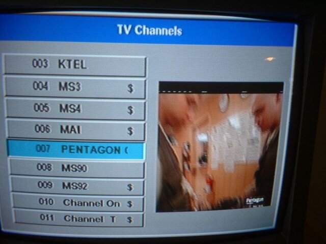

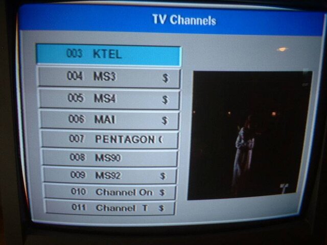

I was playing with my dish and aiming to AMC4. When I did a blind scan I was surprised to find that I get signals from both AMC-4 and AMC-1.
How is this possible? I got only one standard LNBF.

Maybe you are right between them (102w), I have trouble sometimes pointing to G3C as I sometimes land on IA5 even when I use the satellite identification meter I have, about all you can do is go for the weakest transponder on each satellite and point at that, thats a weird one : )
Cool, but the real question is do you have enough quality reading on those transponders from each satellite for a stable signal? :)
Your dish size and location could play into it. It is my understanding for ku signals the larger the dish the aiming has to be more precise or you do bring in more than one satellite. Plus, from my own experience here in w. tx. at 102, the further east or west I try to go the less I have to move my 90cm dish due to the angles involved, etc.
Like Pete, a lot of times when I try to aim at g10 at 123, I actually hit 121 due to the stronger signal on meter, so all I have to do is just barely bump my dish to bring in g10.

it is very possible to pick up 2 satellites 2 degrees apart. When Ive done scans for G3, I'll sometimes get TP's fro IA6. I get no signal quality on the IA6 transponders, though :)
