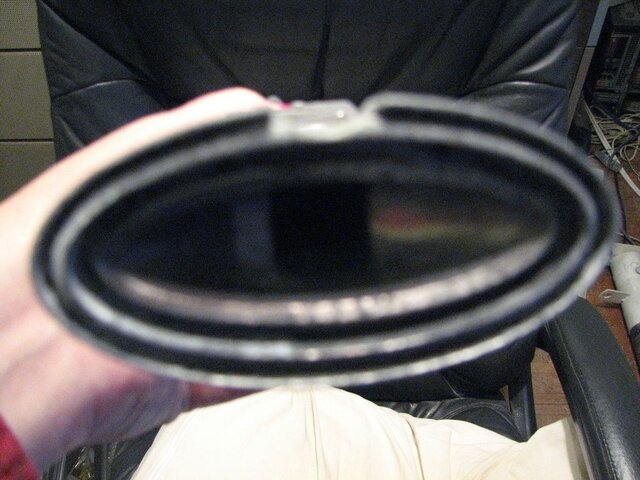

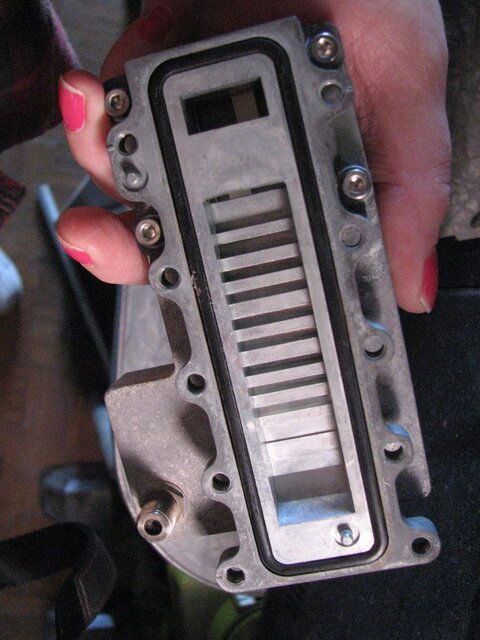

Frickin ~termites~ !
Yep. Termites.. In the face of the LNB there was a clear plastic cover where the signal passes through into the innards of the LNB.
Well, a long time ago I saw water in there so I poked some pin holes to let the water weep out and any future water weep out.
Apparently some infant termites, in their wee-itty-bitty stages found their way into those pin holes, enlarged them enough to let friends and family in and set up house.
There was some muddy mess inside, eggs and of course, live termites.
I ended up having to totally disassemble the entire LNB to flush it out with hot water then blow it out with an air compressor and now I'm cooking the circuit part under a sun lamp to be 100% that there is no moisture under the chips and stuff to short out.
Thank goodness that's all it was. I should be back in biz by this evening.
Lemme tell you, taking apart a directway LNB without the proper tools, NOT easy....

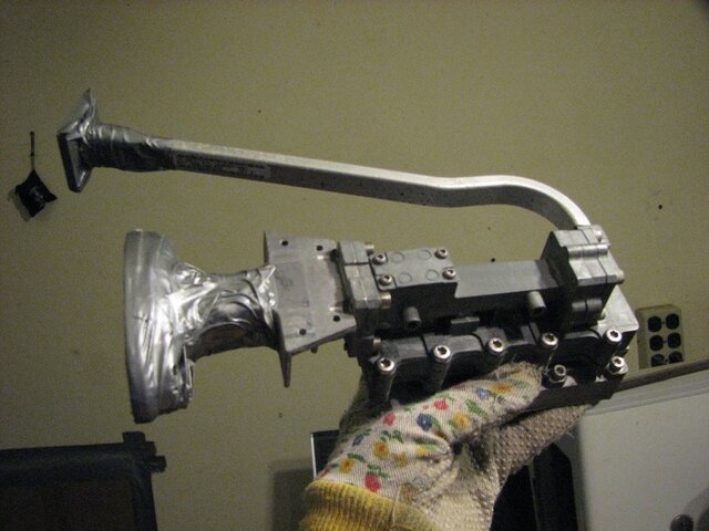

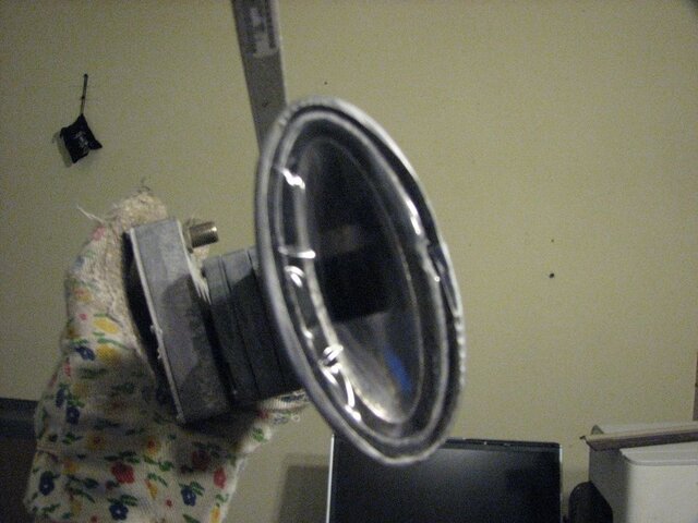

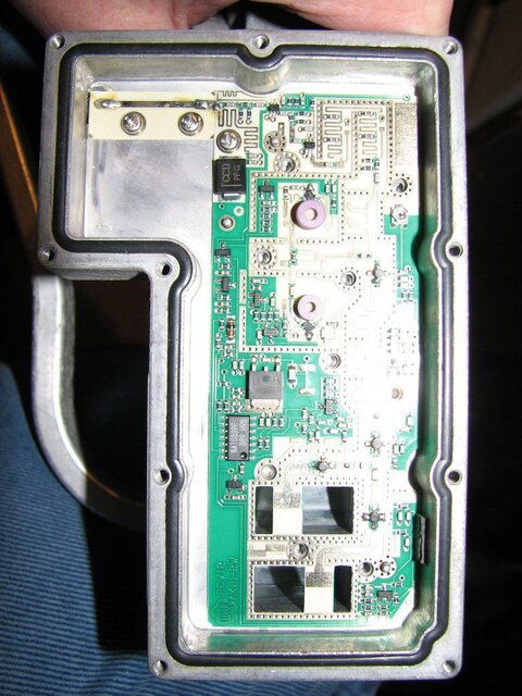

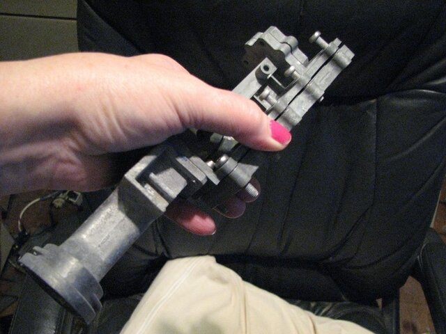

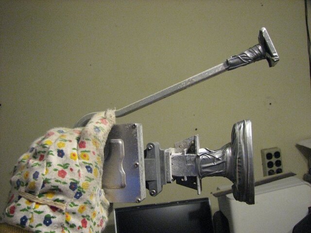

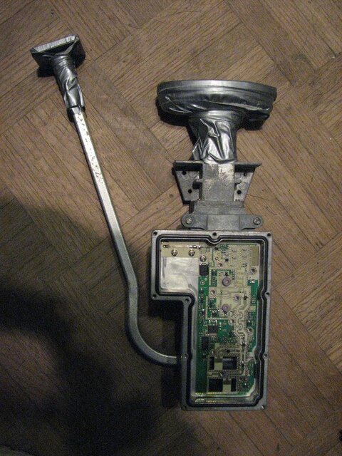

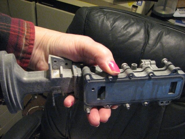

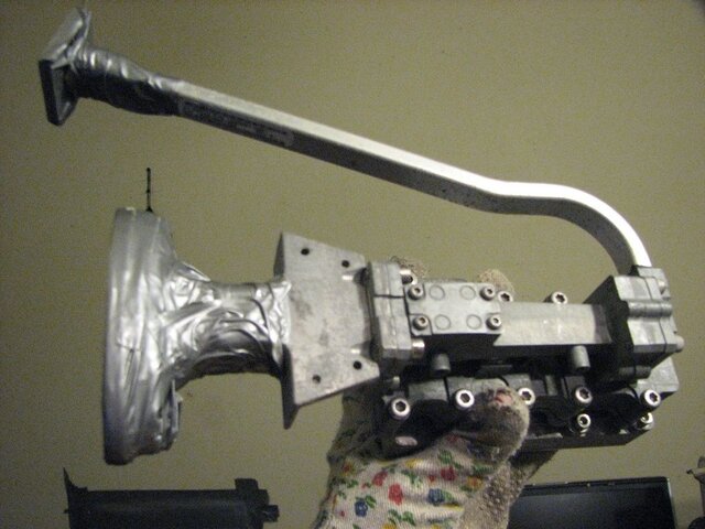

Well, this was a scary, scary day for me. I tore into this thing and had no idea what I was doing. I didn't have the right tools, at all. I needed some little L wrenches which I don't have and some screwdrivers with a star tip which I don't have and some other screwdrivers that are octagon shaped. Which I also don't have.. :confused:
I tried to get into this thing with pliers and that didn't cut it so I went across the street and my friend let me dig in her man's toolbox and I found a few tools that got me into the stupid thing.
After I washed it out with hot water and blew it out with compressed air, it still didn't work. At all. Even less so than before. Like, deadsville baby..
Uh oh.....
So I opened up the part with the circuit board and put it under a grow lamp to heat it up and dry it out. Put it back together and still deadsville. Oh poo... :(
So, this time I took it ALL the way apart. I removed the circuit board even. I found a broken connection that goes from the circuit board to where the cable screws onto the thing so I got out the soldering iron (Thank you Dad!) and fixed it. Thank the giver goddess for my mega strong reading glasses I bought just for things like this!
So again, for like the 200th time, I put it all back together and back on the dish and this time, paydirt! Ta-da! I got a signal. So I used the bird dog and tweaked the dish as best I could, put the main wire back on it, covered the LNB with a coffee can (original cover is missing. :() and went back inside.
Bingo! RTV is back. And it seems the signal is stronger than I ever got before!
Lemme tell ya, I was sweatin it.. I was just about to chunk it all and go on ebay and find a replacement LNB for that thing.
I'm pretty pleased with myself that I actually fixed it all by myself and it didn't cost me a penny!
Oh, and I took a hint from you guys. I invested in a roll of duck tape some months ago and I made liberal use of it today. I took some clear packing tape and put over the face of the LNB since I cut away the original plastic then wrapped duck tape all around to make sure the clear tape can not come off by itself.
So, I think I did pretty good. It kept me busy all day and distracted me from my pain and problems and pulled me out of my depression a little so today was a big WIN for me.. :D
I included some pictures though I wish I had taken better pictures during the process of taking it all apart. The pictures were more or less an after thought, I just picked up the camera at random and snapped a few here and there.
