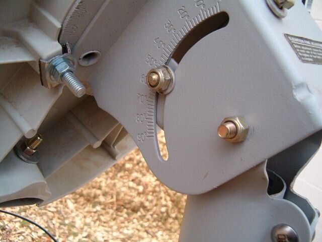

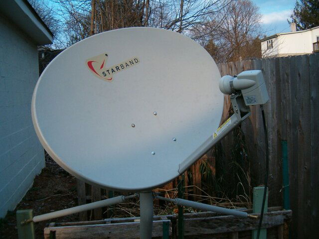

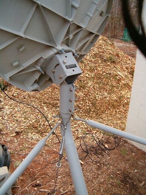

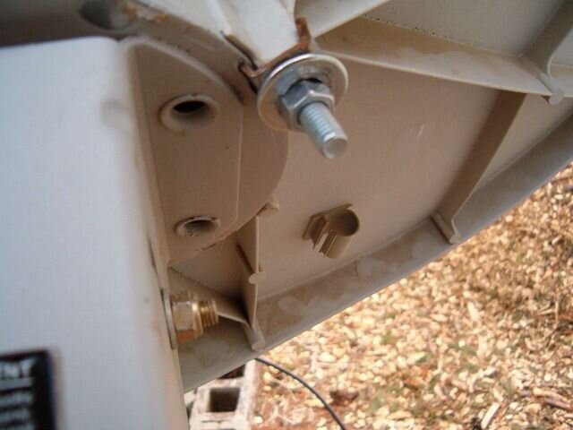

I have a Starband dish (Channel Master 74E type) with skewable mount. Over the weekend I removed the factory LNB which is very heavy with a transmitter included and replaced it with a Sadoun KL2 dual linear LNB, attaching it to the LNB arm with a fabricated metal plate and stainless steel hose clamp. I had a lot of trouble finding G25 at 97W. I set the skew at +24, then started panning left and right, adjusting the elevation, panning again. This went on for a couple of hours, then I gave up on that approach. I had a compass several feet in front of the dish, pointed the dish as accurately as I could in the right compass direction, then started doing blind scans with my Mercury II at different elevations. I finally scanned in some transponders and some TV stations which turned out to be for SatMex 6 at 113W. This really surprised me because 113 and 97 are 16 degrees apart. I've pointed regular non-skewable dishes successfully a number of times now and have never been even close to that far off on compass direction. The other thing that puzzles me was how I was able to receive SatMex 6 which needs a skew of something like +40 here when I had the skew set at +24 for G25.
I fine tuned the elevation and azimuth to peak 113, then working from there knew I had to increase elevation by 8 degrees and move left 16 degrees to get G25 and I finally got it. G25 is at 39 elevation from here (Philadelphia area) but the elevation on the dish mount read 46, off by a good 7 degrees. And yes, the mast was plumb, it was mounted on the side of a rickety pallet used as part of my compost bin but I had used a coat hanger and turnbuckle to jack the mast with that heavy dish on it up to plumb in all directions. Maybe the non-factory jury-rigged LNB changed the needed elevation for the dish.
But my basic question for y'all is this: when you have a dish with a skewable mount, does that change the compass direction you point the LNB arm at? With the dish skewed, does that change the angle the signal comes in at?

On a skewable dish, if you set the skew to zero, and point the dish south with your compass, it'll be right on.
Now, let's say you skew the dish over 90 degrees.
It's still pointing south.
But, which way is the LNB arm pointing?
The dish is supposed to still be pointing south, but you'll be fooled by the LNB arm.
Next thing to screw the pooch is the LNB mounting location.
If you didn't locate your LNB at exactly the same height as the original, then you've effectively messed with the elevation.
But what's worse, is that the skew mount was calibrated for the LNB being in the right place and now it isn't.
So, as in the example above (set skew to zero, point south, then skew the dish), you will no longer be pointing in the correct direction NOR have the correct elevation.

Bottom line this is a terrific dish. Once I finally found G25 I got very good signal quality and it locks on all those channels rock solid, even after passing through 2 switches and 150 feet of coax. The mount is real heavy and well made and I like that it has a jack bolt for fine adjustment on the elevation so you can adjust it just by giving the jack bolt a quick turn with a wrench, unlike other mounts where you loosen bolts on either side and risk having it slip way more than you wanted to when you get down to making fine adjustments.

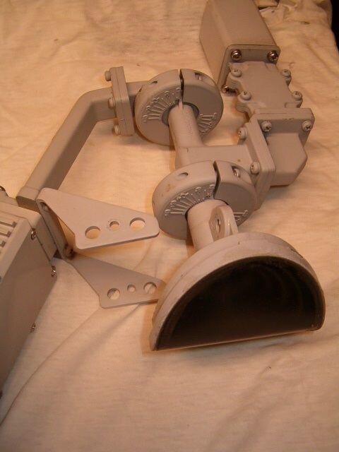

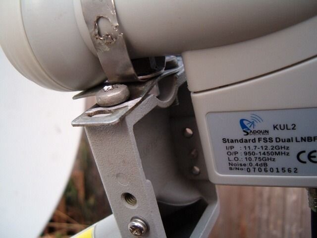

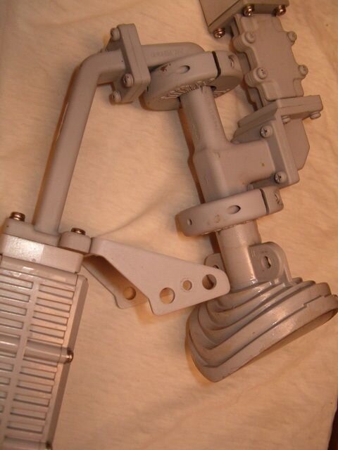

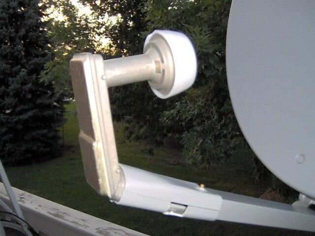

I can't answer any of your questions but I am interested in how you mounted that LNB to the feed horn. I have the same dish. Is it possible for you to take some close up pictures of it showing exactly how you did it and the individual parts if possible, Thanks a bunch.
Here ya go. In the second picture you can see that all I used was a metal plate I had lying around and a hose clamp which I bought at Home Despot for about a dollar. I drilled three holes in the metal plate, two to go in the holes in the LNB arm (I used the original Philips head screws) and one in the center to bolt the hose clamp to. The last two pictures show the original feed horn/ LNB assembly. In the fourth picture you can see my fabricated clips on the back of the dish.

See how your Sadoun LNB sits higher than the original?
That makes your dish aim lower (mirror effect)
So, you had to increase the elevation to make up for the down-looking LNB.
Get that LNB neck down in the original half-moon curve at the end of your bracket, and it'll probably fix both problems.
Sometimes ya need to take the large diameter plastic off the neck of some LNBs, exposing the small diameter throat tube, and that may fit the half-moon better.
I don't have one here, but you can tell from inspection, what needs to be done.
Iceberg has posted on the subject a number of times.
Maybe you can find one of his pictures where he did that very thing (though, maybe on a different dish).
Or, if it works, leave it alone, 'cause you're done! - :up
You're right of course. And if I did all that I'd be closer to the original design specs of the dish and probably would get a smidge more signal. But you know what? I'm lazy and it works the way it is.

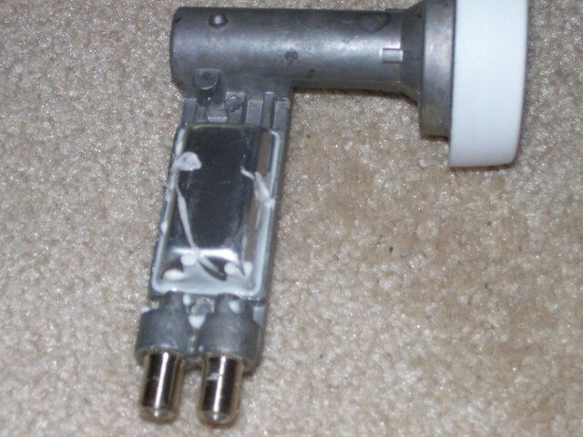

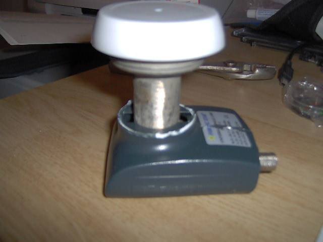

ta da ;) Cut the casing from behind the eye like the pic and that will fit right into the 25m slot on the dish

yep the LNB is sealed so even if its "naked" (no casing at all) its sealed tight.
While back I had a couple Dish dishes up (when I had a Dish sub) and the LNB's I used had no casing on them
last pic is a KU LNB that I gutted because it was bunk :)

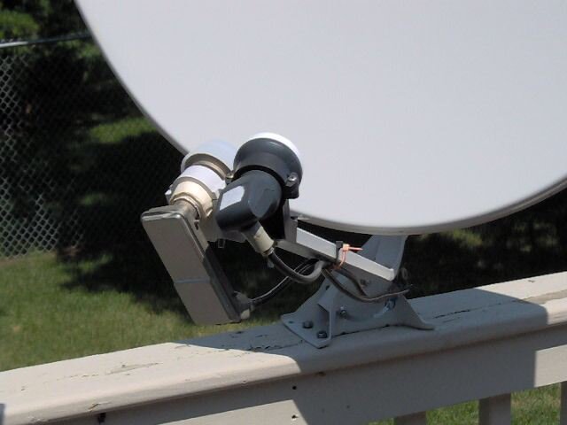

pix of hardware
Thanks, Iceberg. Great pictures. And since a pix is worth a thousand words... ;)
This link on our forum shows several views of that -U- bracket discussed above.
It should be fairly cheap, and apparently comes in a size that fits a Primestar spacing pretty well.
And this picture is another thing you'll find in the hardware store.
I think it's part of a grounding clamp. (suggesting you get -two- of the brackets for your purchase)
Might cost more, but if you're only using one, then who really cares if it's 50¢ or $5 ?
As long as it gets the job done!
. . . and looks stylish . . . - :eek:
edit: giving credit where credit is due:
George, that ground clamp idea was pure genius.
I found the above ones at Lowes this morning for $1.67.
I modified it just a little, but now have two working halves to use and have a spare for more dishes.
The holes line up perfectly, and they are solid without being too thick like the original.
