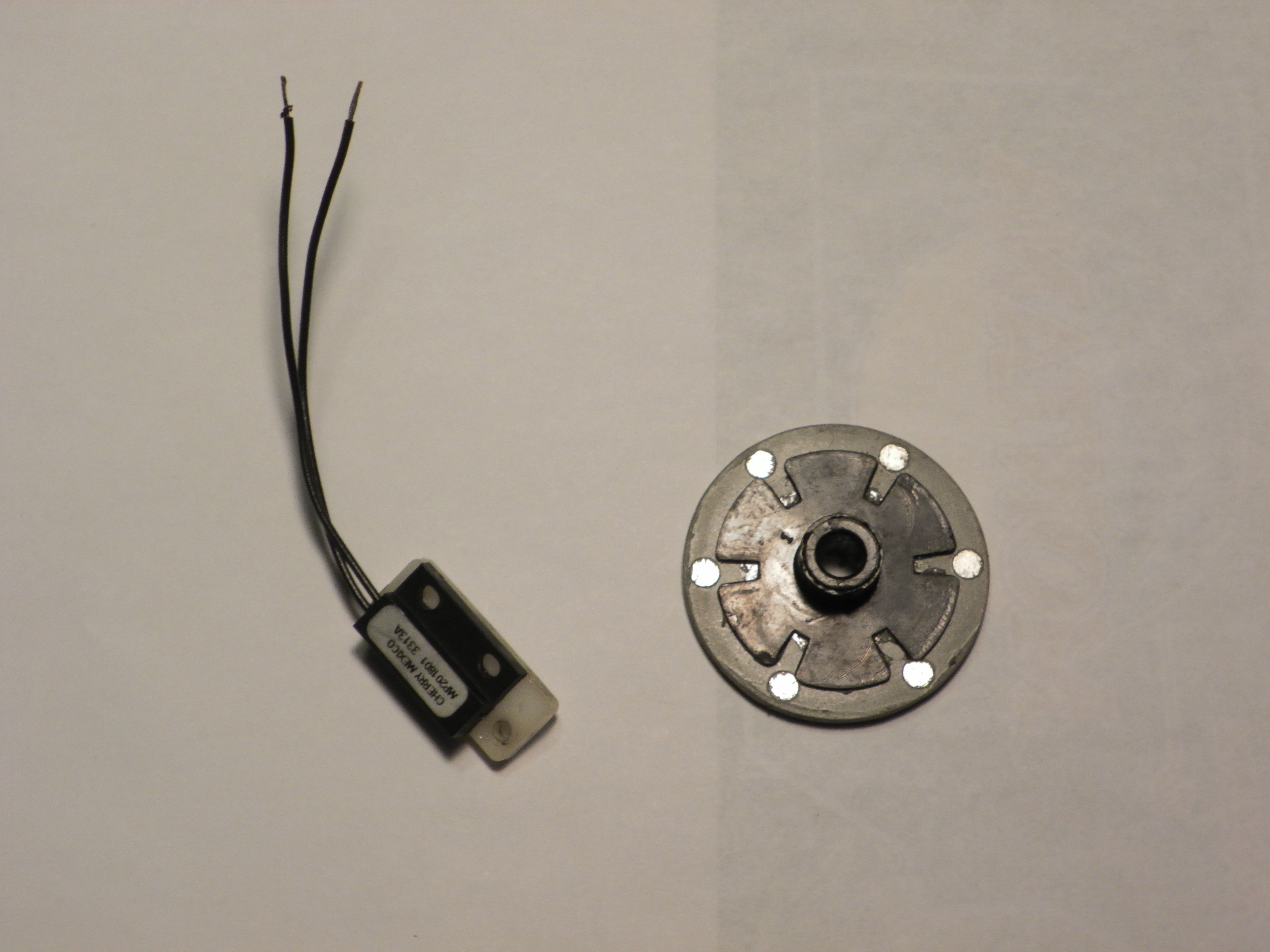

Well you look like a "Hands On" kind of guy. :) So if you think you can make something work, I can send you a magnet wheel and reed switch that I used to mod a VonWeise that had an optical sensor. I have also used those parts on a Venture actuator. Just takes a little imagination to get these parts installed sometimes. I can post some pictures but my computer is down for a power supply until tomorrow night and I don't have access right at this time.

Thank you, Magic Static, for the magnet wheel and reed switch. Installed on top of original without losing ability to go back original. Waiting for ASC1 to be delivered this week to test functionality. Again, thanks to Magic Static.
More pictures of the wheel and switch used in other actuators :) The VonWeis converted from optical. and a old Venture I use for a test bench motor.
The VonWeis, I just glued the magnet wheel to the optical slot wheel and removed the optical sensor and mounted the reed switch in its place.
In the old Venture, I took the original glass reed switch out of the housing it was in and put another glass reed in the same housing but on the other side. This lined it up for a larger diameter magnet wheel too. I also have used the same reed switch as Montana 16 is using in this one too. I can be mounted to the same spot as the original switch.
